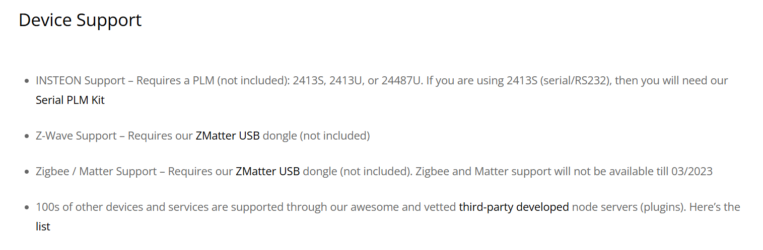

What makes you say this?
From the wiki: https://wiki.universal-devices.com/Eisy:User_Guide#INSTEON_Support
Quote
INSTEON Support
eisy supports the following PLMs:
  • 2412S
  • 2413S
  • 2413U, and
  • 2448A7
If you have the 2412S or 2413S (serial), you will need our Serial PLM Kit
eisy only accepts USB connections for the PLM. (The network port on the eisy ONLY supports a wired network connection.)
Perhaps @Brian H is more accurate with the reason(s) not to use. However, if the eisy indeed supports the 2412S and that's what @windrockwater has then perhaps it would work with the correct cable for connecting to the eisy. Of course the serial PLM kit is needed.
NOTE: @windrockwater if you have the old serial cord that came with the serial PLM (I'm not even sure if the 2412S might have included it...I know it came in my 2413S). You could try an adaptor from Amazon (this cable has worked for me since getting the eisy) to try the PLM you already have. Otherwise, you'll need the PLM Kit that UD is selling. That's the best (single cable) way to go from older Serial PLM connector to USB. And the only way UD supports troubleshooting possible PLM issues by using their cable/kit.
