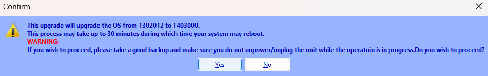

When I go to run the upgrade, I get the following message, which seems good . . .
Within a few seconds of that, my Polisy reboots, and comes up running again within a minute or so, running the same old version.

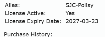

For what it's worth, my ISY Portal license is active. Is there anything else that would cause the upgrade status to be "inactive"?

Everything seems to run fine after this, but the upgrade simply never happens, and never appears to really get started. All this happens in about a minute (or two), rather than the 30 minutes warned by the dialog when starting the process.

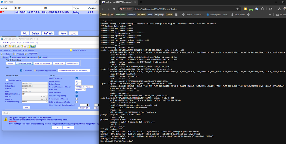

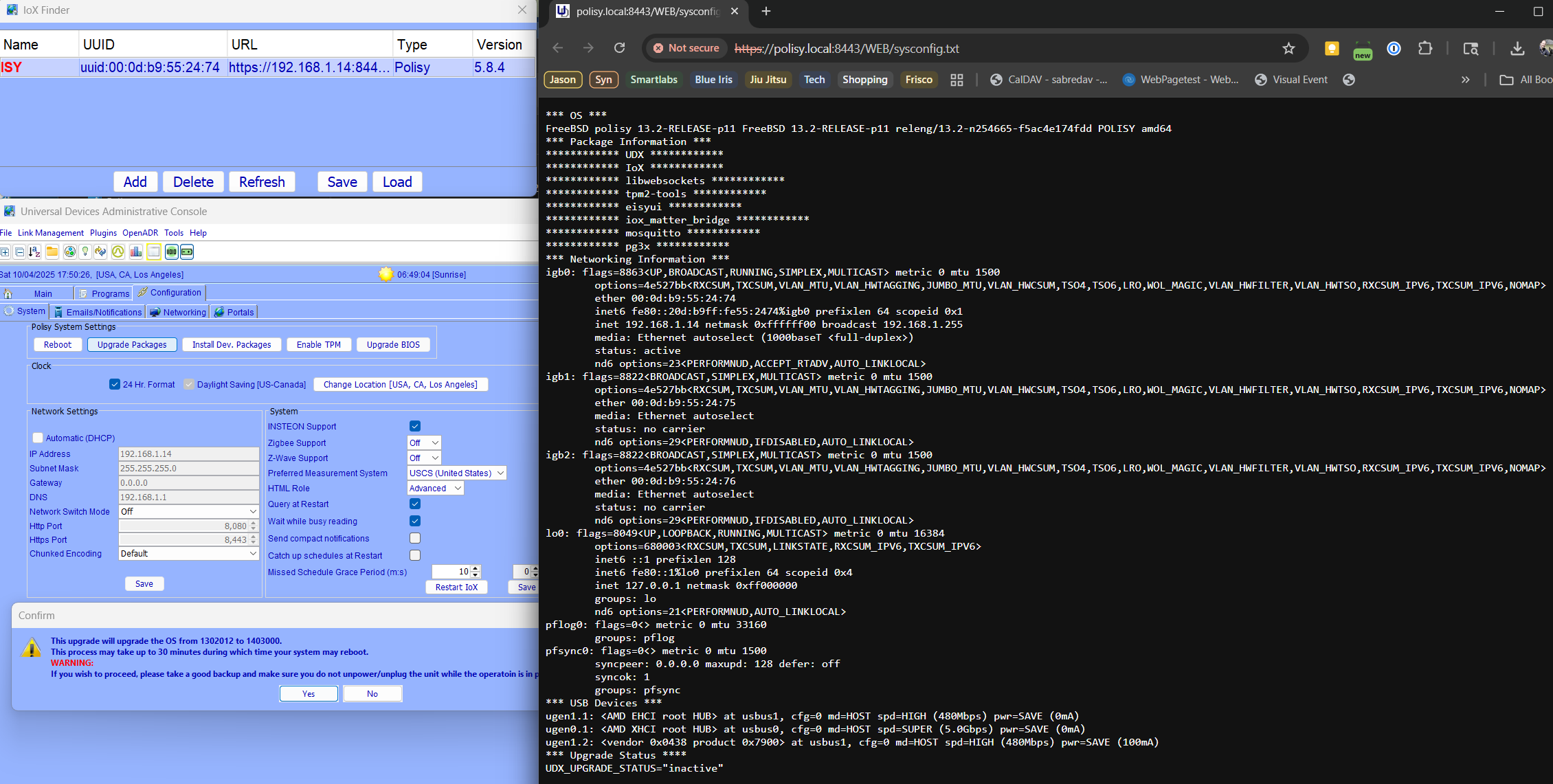

I'm not entirely sure what you mean by "launcher", though that sounds like the IoX "Finder" as I know it. I'm not directly doing it from that, but I use the launcher/finder to open the admin console, then go to the config tab, then click "Upgrade Packages". This screenshot shows that sequence, from top to bottom.
I did just remove the power entirely and don't see anything substantially different. I'll include the sysconfig.txt in the screenshot as well (after reboot). Sounds like a support ticket and just waiting for help may be my only alternative at this point since you say I'm missing a lot of information.
