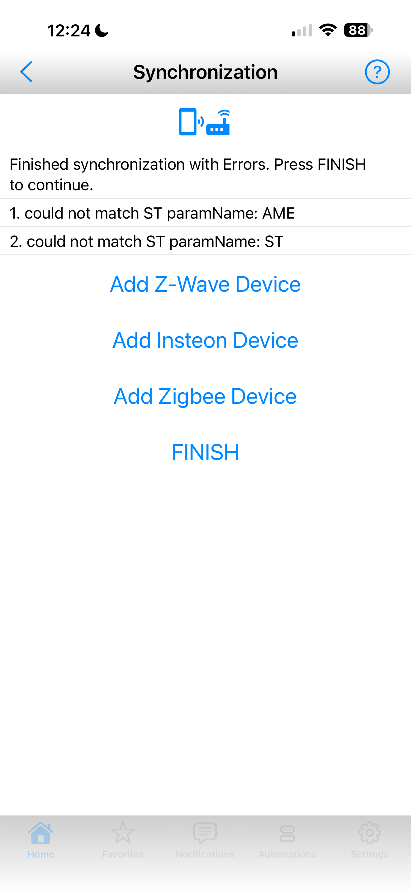

Getting this error message on UDM (1.34) on iPhone iOS 26.1 after upgrading to IoX 6.0.  Any thoughts?

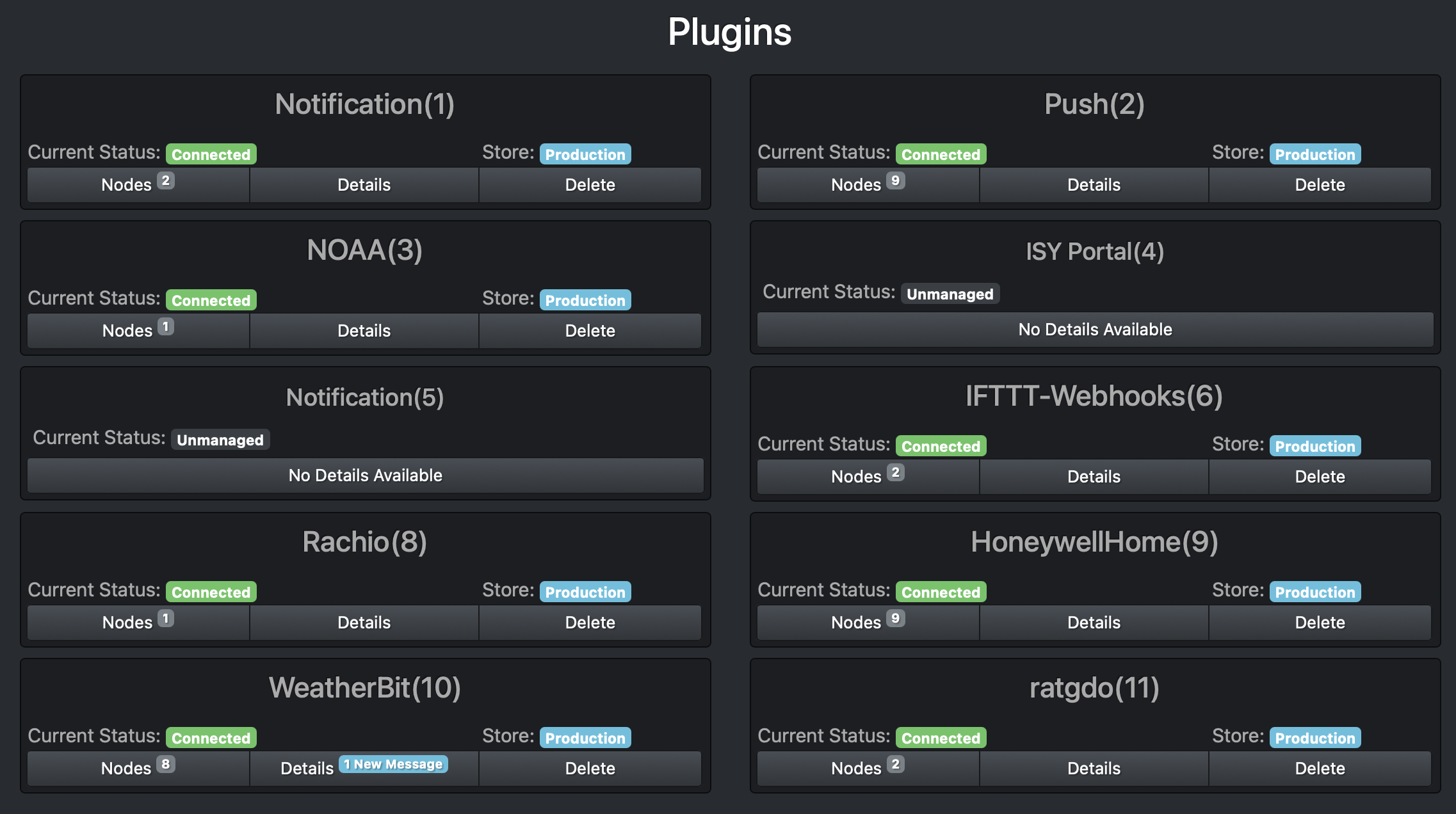

That's odd.  I now have 2 "notification" plugins.  I assume I should delete the unmanaged one in slot 5.
I deleted the unmanaged Notification plugin and that solved the issue
’m also having sync errors since upgrading to 6.0.  These 2 errors occur during sync when “Getting family Nodeserver” (running UDM 1.3.4 on iOS). I have tried re-installing Notificaitons, but the errors remained. I then tried reinstalling all the plugins and rebooting the EISY without success.  Any thoughts on what is the source of the errors?

I don't think they are errors which will cause issues.  It is likely an invalid format in a human readable name for a node server.  The next version will list the Family (i.e. Node-Server, Insteon, etc) and instance (i.e. node server slot).  Please post the same screenshot when they Family and instance are displayed and we can investigate further.
