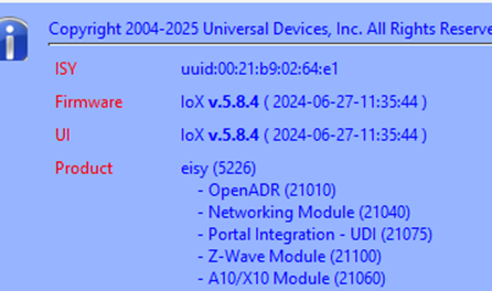

Firmware and UI versions

I unplugged PLM for a couple of minutes to get the 4 digit and revision numbers.  Still not was not receiving device events.  Rebooted the Eisy and still not receiving device events.  Queries and state change operations still work. Don't think I use scenes (versus programs) so did another Restore Device with no change.  I will create a polling / query routine for some devices near term.  but have 50 or so devices and have not researched network bandwidth and power implications.
