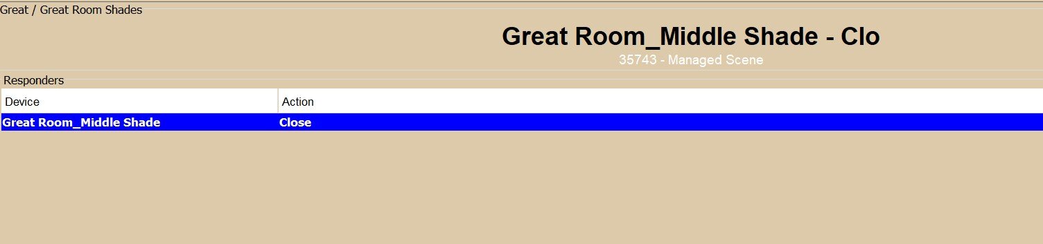

@bmercier The shades with the plugin have been working great. I was doing a little adjustment after installing v6.0.0 and noticed something odd. When I added my Middle honeycomb shade to an eISY managed scene it shows up three times when opening it later. See attached images as it shows 3 times in tree but once in the scene device list . I deleted and added the scene and the device in the scene a few times with same results. Other identical scenes for Right and Left shades are fine.
Also, I had added two Lutron scenes that grouped my 3 shades a few weeks ago. I hadn't needed them exposed immediately on eISY so I had not discovered them via plugin. When v6.0.0 was installed and I assume querying and appears doing a discovery (took 45-50 minutes for that stage to complete) the two Lutron scenes were added at top of device. One of them was as expected added once and the other was there three times (same as issue above). I decided to perform same function with eISY scenes, so I have since deleted them from Lutron app and they are gone from eISY Not that its important here, but I did have to fight Alexa to get fully rid of them -- not sure its complete yet.
