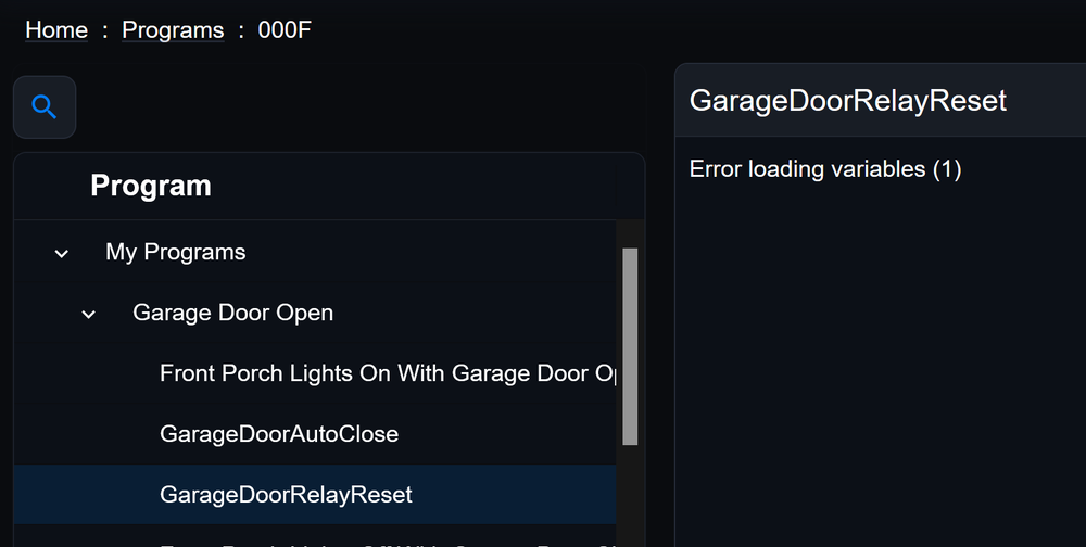

Lastly, I probably should create a new post but I'll try it here; In the new web/browser based gui, when I try to load my programs, any program, I get Error Loading Variables (1). I realize that the new UI is not at 100 percent, but just checking. Is this my error or a not yet mature UI error?
That's a bug, and I'm pretty sure I know the cause.
First of all, to display programs, the UI needs to load the resources a program may be referring to, such as variables.
This calls a rest API that returns the variables. If an IoX never had variables, the API fails with a 404. This is probably what is happening here.
So here's a work-around:
Go to the admin console, programs, and make sure you have at lease 1 state variable and 1 integer variable. That should clear up the error.
You probably can delete them as well, this is likely to still work afterward if you don't want to keep "dummy" variables.

@bmercier THANK-YOU! That worked! Had plenty of State variables bit no Integer variables. Other odd things have shown up that I will post separately.
