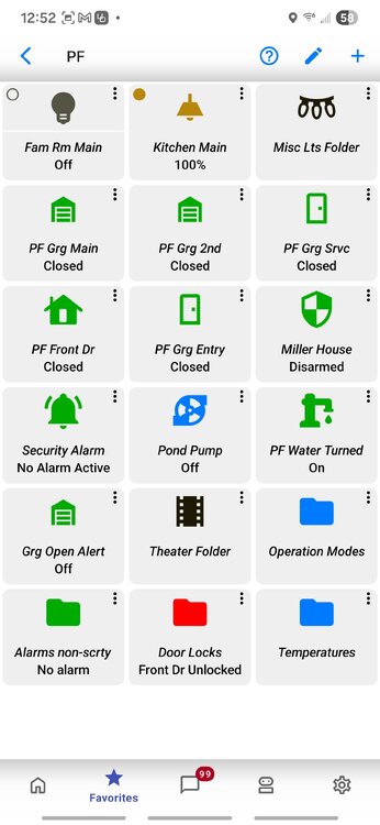

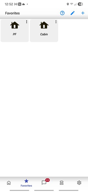

Here are some screen shots of several page configurations I have set up -
Top Level - The 2 houses
2nd Level - PF (Home)
3rd Level - Temperatures Folder
