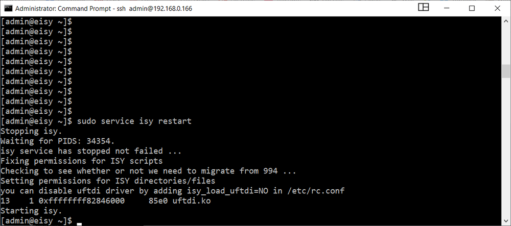

November 14Nov 14 So the eisy is there. Harmless thing you can try: redo the ssh command and enter "admin" as the password. If that doesn't work, try your IoX admin password. When you get to the $ prompt, try restarting the isy service:$ sudo service isy restartYou should see messages like shown below, if it restarts ok. Any error messages might give you a hint as to what might be wrong.
November 14Nov 14 Author here's what popped up. I have no idea what it meansisy not running? (check /var/isy/isy_svc.pid).isy service failed since no process with id 12718 exists ...Fixing permissions for ISY scriptsChecking to see whether or not we need to migrate from 994 ...Setting permissions for ISY directories/filesyou can disable uftdi driver by adding isy_load_uftdi=NO in /etc/rc.conf 7 1 0xffffffff828b4000 83a0 uftdi.koisy: 1763156932 -> 0Starting isy.
November 14Nov 14 Well, it couldn't stop the isy service because it wasn't running...which corresponds to your problem. Otherwise it says it's restarting it. So try connecting again to the admin console. It it still doesn't work, you'll probably need help from UDI.
