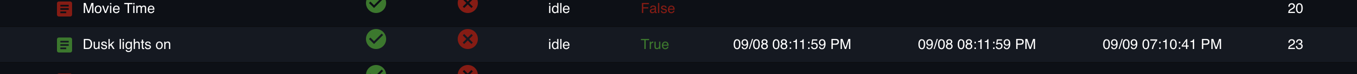

  8. Well oddly I'll have to say I can't find a time and date in the eisy-ui now that I go looking for it. I have to think that it is however, because that screen shot from after running the "then" updated to the current local time that I ran them at.
  9. Yes - runs perfect. I had avoided doing so tonight for troubleshooting, but did just as you note and all the lights came on as expected. So it appears the issue is the SUNSET trigger. The last Run Time and Finish Time also updated.

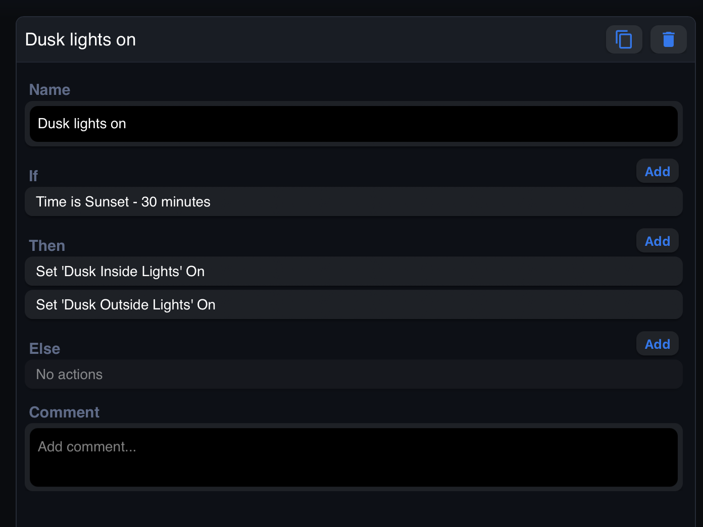

  10. I know this likely needs a ticket, so I'll open one in a bit, but thought others may have experienced the same or have some insight. I've got an EISY and am using the new GUI (not IOX). I upgraded a couple of nights back to all of the latest code releases. I have a Program that runs a couple of scenes every night, 30 minutes before Sunset. Its worked for years. After the upgrades it is not running. I have looked through a few of the logs, but don't see any errors and it seems like our list of logs has exploded. Anyone have a quick insight where to look for an error or what might have gone wrong? From the programs listing it shows a next run time for tomorrow at about 30 minutes before sunset, but there is no "Last Run Time" nor "Last Finish Time" documented in the EISY-UI. I've right clicked to copy the program and I get the next dialog box, but it won't paste, so maybe another GUI error? I have Alexa connected and have spokens set up for this Program, it will run and did last night, if I ask Alexa to run it. Any insights?
  11. By the way - to fix the issue, I rebooted my EISY.
