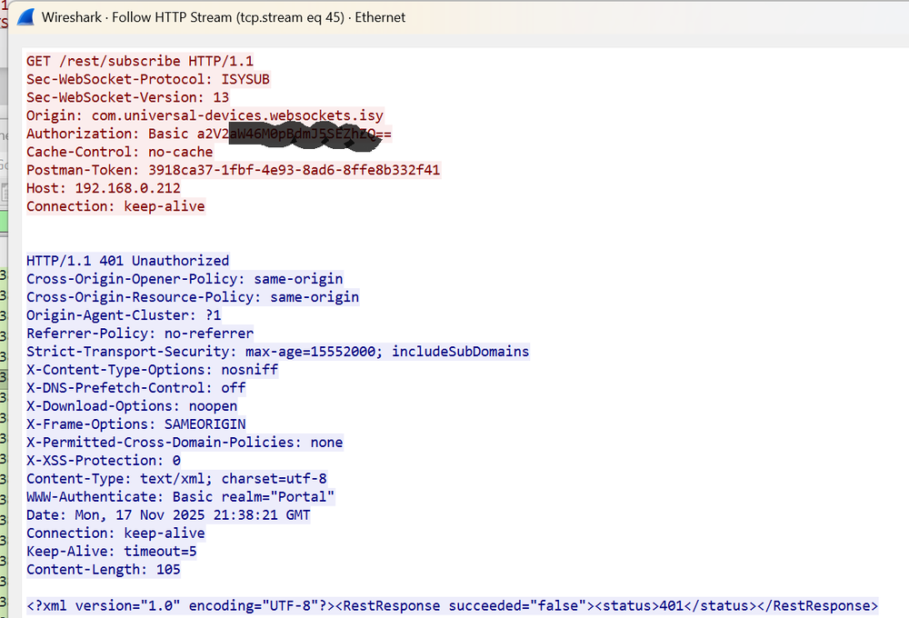

I am trying without luck to subscribe to EISY events using an Arduino program. I am trying to follow the SDK manuals examples, but I am apparently doing something wrong such that all attempts to do a rest/subscribe fail with either an error 400 or 401.

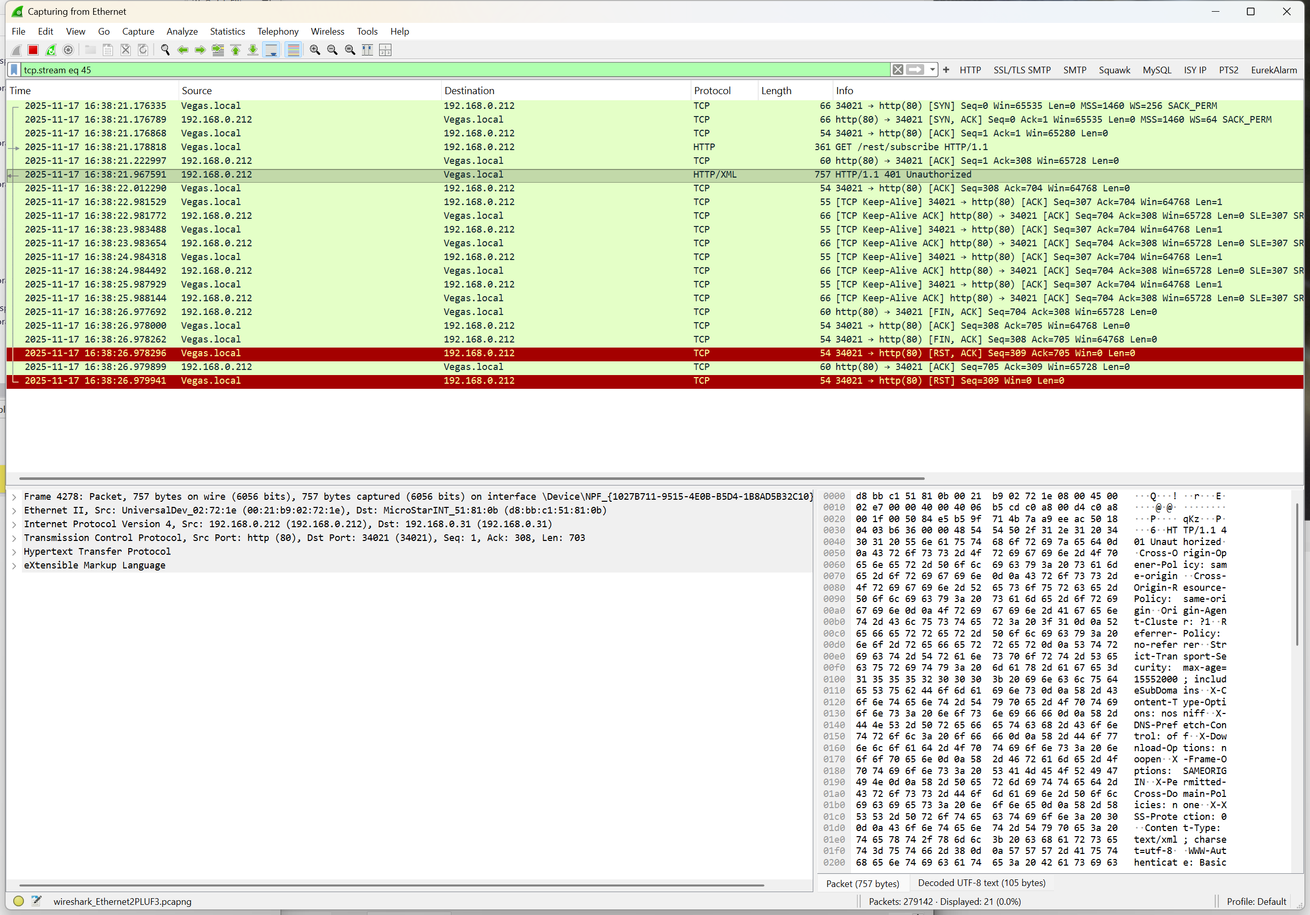

Attached is a screenshot of a Wireshark capture of Postman trying to connect to the EISY. Any idea of what I am doing wrong? I tried both port 80 and 8080. I want to get things working on Postman before I commit to coding the Arduino REST subscription/event handling.
Can someone send me Postman setup params that can launch a subscription session on EISY?

Yes, I know that a 401 error means there was a failure to authorize. The problem is that I used the same basic authorization on my EISY polling software as I am doing with the attempted REST subscription. Polling works, subscribing to EISY events does not work using the same auth code.
Once I get past the auth problem I need an example of subscribing to EISY events using REST. The EISY documentation is not too helpful for this.

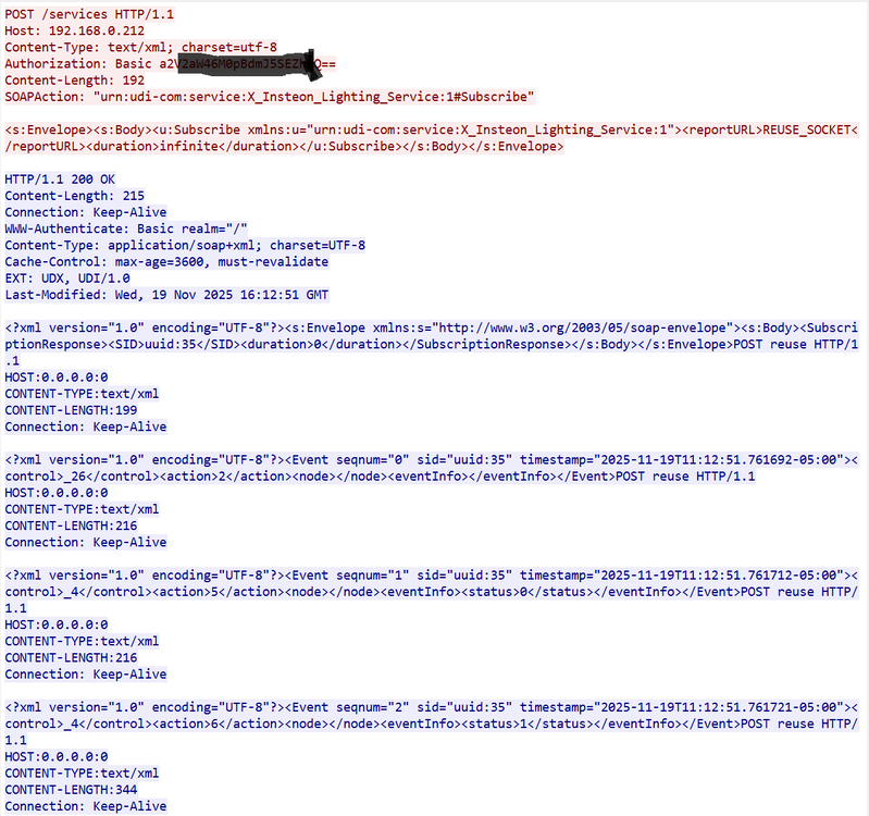

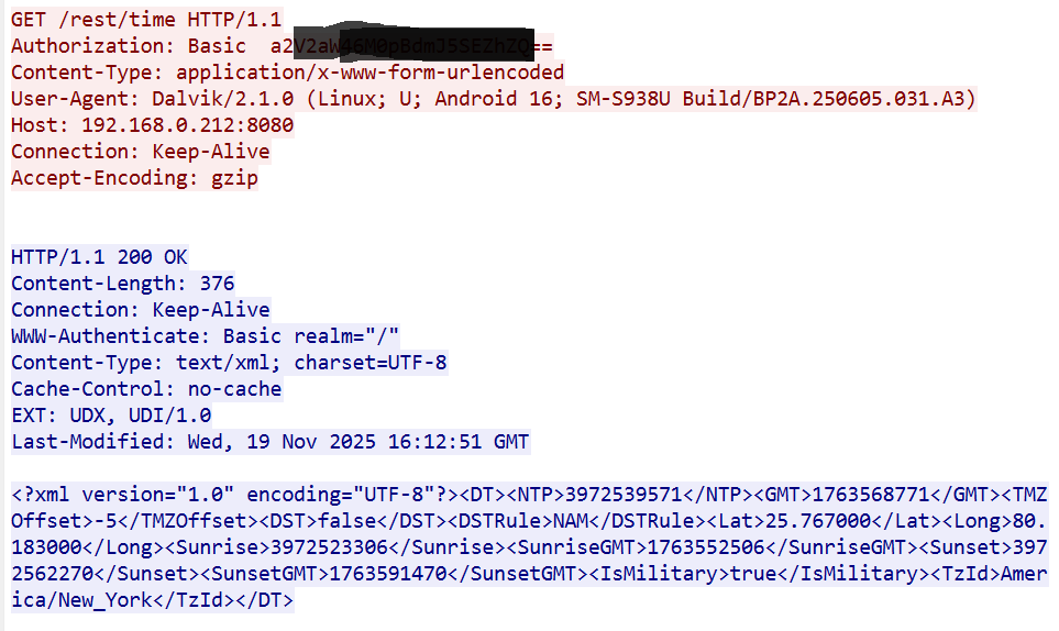

I did a bit more research by sniffing the packets generated by UD Mobile that arrive at the EISY network connection. I found that subscribing to EISY events is done using SOAP. UD Mobile starts off by querying the local time on the EISY with a Connection: Keep-Alive. My guess is that this is just a way to get the subscription conversation started since we don't really care what time of day the EISY thinks it is.
The red text comes from UD Mobile and the blue text was generated by the EISY. I blacked out my authorization credentials.
Now that we have a nailed-up keep-alive connection, UD Mobile subscribes to EISY node events using a SOAPAction call:
The EISY replies with a gazillion XML packets that show the status of every node it knows about - in my case, around 100 of them. Last, it sends updates for node values that change.

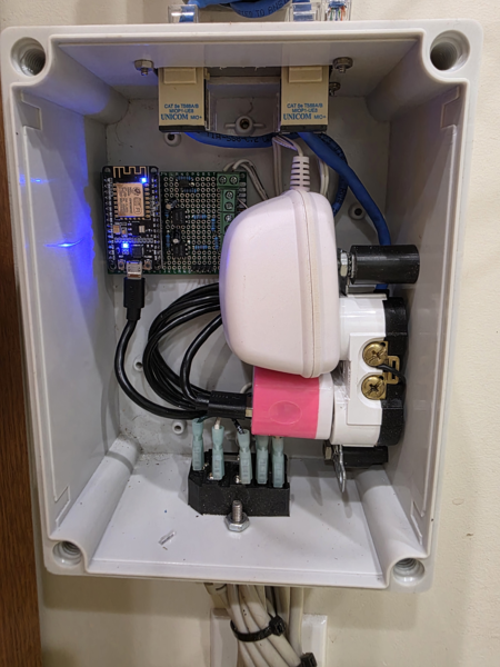

I built this box that powers a 2441TH Insteon thermostat and creates IR remote control signals for the AC unit. It would also work with any thermostat that can communicate with the EISY.
