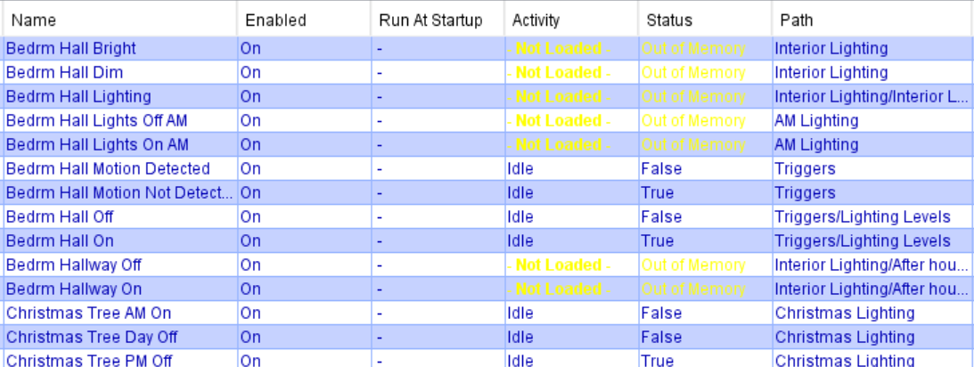

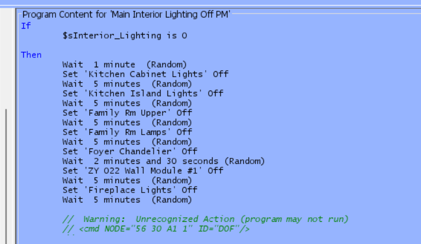

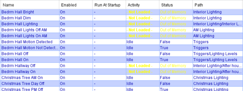

Now it seems that whatever program was "touched" by the device that was removed, locks up and I am getting the messages noted on the Program Summary page and within the programs themselves (note the comment at the bottom of the program). The device that it is referencing, is the device that I deleted before attempting to replace it.
How do I clear this problem out of the system? I have tried rebooting several times with no success...

It appears you didn’t do a replace device and just added the new device. Therefore the removed device is still reference in those programs. You need to update programs to do whatever is needed using the new device.
Issue resolved ... As it turned out, all my problems tied back to the fact that I had lost the connection to the PLM.
I rebooted the PLM and the Eisy to restore communication to my insteon devices. Then reinstalled my original dimmer and re-linked it to my eisy. At that point, the dimmer reappeared in my programs, where it was originally and all the error messages went away :D.
