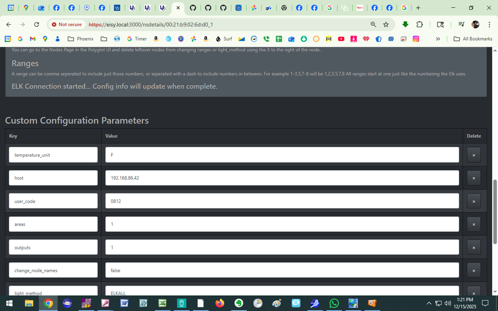

The PG3 is stuck at ELK Connection started... Config info will update when complete.

Thanks for your reply
My secure port is set to 2601. Should it be blank?
You must use non secure port as shown in the plugin instructions. The plugin will not work with the secure port.
You also need to follow the example in the instructions for adding the port at the end of the IP address, :2101.
