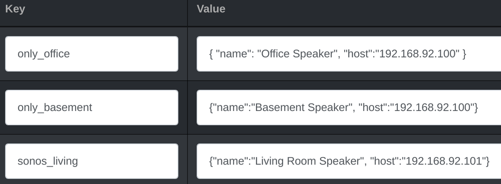

January 6Jan 6 I've uploaded a version of the Sonos plug-in to the non-production store. This version supports adding specific speakers and doing so, disables the auto detection of speakers. I've added the join/unjoin commands.I've tested it as much as I can by creating a speaker simulator, but that really just allows me to create the nodes, it doesn't allow me to test the join/unjoin commands as I can't figure out the communication needed to do that.To add specific speakers, you use a similar method to adding speakers manually, by adding custom parameters:key = only_<unique> where <unique> will be the unique speaker address. For example: only_livingvalue = {"name": "<speaker name>", "host": "192.168.1.43"} where <speaker name> is the name of the speaker (and will be the node name)You can add as many as you want, but I think only the first 5 will currently work. There are a number of cases that I don't account for and have no idea what will happen if you attempt them. You are supposed to only join a speaker to a coordinator, but that's what causes all the trouble with ST-Sonos, which speakers are coordinators changes dynamically. My implementation in the Sonos plug-in ignores that. It will allow you to attempt to join a speaker with any other configured speaker. If that speaker is not a coordinator, it should ignore the request, but may crash. I believe unjoin will fail silently if the speaker is not currently joined, but again, it could crash.The list of speakers generated for programs should be always be the same (for the same configuration). I think this handles your use case so try it out and let me know.

January 7Jan 7 @pjjameso When the custom parameters are correct, it should skip the auto detect of speakers an it should display a notice in PG3 that it did skip auto detect. Here's my configuration. With this configuration I get two speaker nodes; Office Speaker and Basement Speaker. No Living Room Speaker node is created since using the "sonos_" prefix in the key is handled as part of the auto-detect code in the plug-in. So I'm pretty sure it is bypassing the auto-detect code. But since I have no real speakers, I can't be 100% sure.
