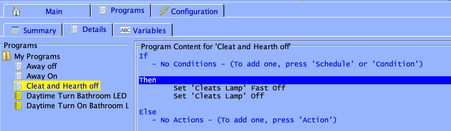

Here's that program:
<?xml version="1.0" ?><triggers><d2d><trigger><id>40</id><name>Cleat and Hearth off</name><parent>1</parent><if></if><then><cmd id="DFOF" node="7191"></cmd><cmd id="DOF" node="7191"></cmd></then><else></else><comment></comment></trigger></d2d></triggers>

Thanks for posting, but you didn't use "COPY" you used export. The last option when you right click on the program will be "Copy to Clipboard". That gives a much cleaner and user friendly paste for the program. Since it's a simple program the above screenshot will work for now. It's not a program issue, it's likely a scene issue.
I do not use many scenes so cannot try to describe what you should look for in the scene settings or in the program itself. Perhaps others that are scene gurus can chime in to help.
That program appears to be set up correctly to me. (The two yellow programs below it have something wrong, but this should not matter.). I would right-click on you "cleat and hearth" program, then choose "run then" to confirm that this is the program that is not working. If you follow @Geddy advice and find that turning the scene off directly from the admin panel does not work, then you might restore the affected devices. Failing that, you might consider a new communication problem that may have arisen.
