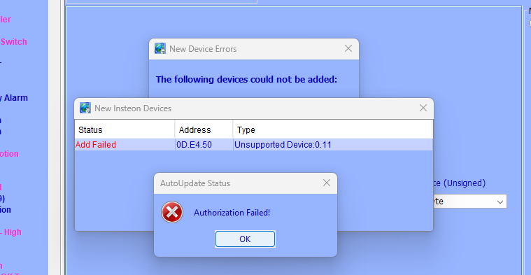

Old error messages whenever opening admin console
This has been an ongoing trend for a while (probably over a year now), but I'm just now getting more annoyed with it since I have to open the admin console more for the updates I'm making around the house.
Anyway, whenever I open the admin console, I am met with the ghosts of error messages past.
Sometimes more than one (as seen below), sometimes only one (usually the AutoUpdate Status/Authorization Failed! message) will always appear whenever I open the admin console. It doesn't matter if I clear the message, clear the Java cache, try a different machine, reinstall Java, reboot IoX, reboot eISY, etc. I am always met with a slew of error messages when I open the admin console.
Has anyone else encountered this and know how to get rid of them for good?

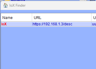

Wnen you finally clear the messages what is the IoX Finder displaying
It appears that the finder is trying to open a device rather than your ISY. Try to add your controller to the finder, then delete the bad address and then hit save
When I clear the messages, it displays exactly what I would expect.
The IoX finder does appear to be locating the controller correctly. That's the right IP address and as far as I can tell that's the right URL format.
What am I missing?
Click on add, add a second line with the correct information. Then delete the first line and click on save.
