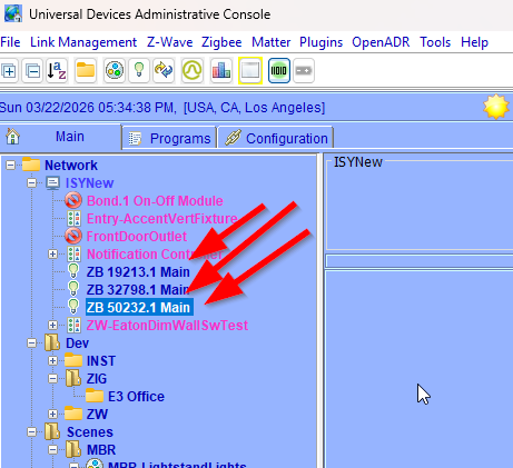

When I upgraded to v6.0.5, my zigbee devices stopped working. I couldn't query or add ANY zigbee device back to my system that actually worked.
I tried factory resetting the zigbee side of the UD ZMatter Zwave/Zigbee dongle and that didn't help either. When attempting to add a Zigbee device, it would be discovered as a generic device that wouldn't update status or control anything. (See screenshot attached).
