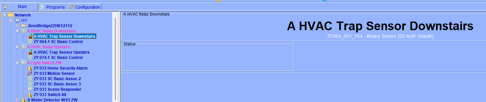

Per instructions, I added the device to my Eisy (version 5.8.4). Once added, per instructions, I set parameters 2 and 3 to 10 and parameters10 and 11 to 0. Then executed an exclude and include again. The unit comes back with the S1 relay containing the expected new child entry. Nothing new for the S2 relay, but that seems to be a known issue with the ZEN17.
I then test the new entry with a low voltage transformer and it recognizes the on and off status. But once I power down the ZEN17 and power it back up again, the new child does not work anymore. I can't query it and the on/off status never shows up again. I have tried this with two separate ZeN17 units and the results are the same. I have excluded/included and interviewed many times and nothing seems to solve the issue.
