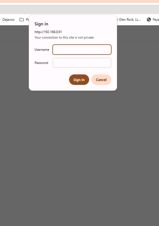

I built an app for my business that most of my staff is on during the day. I think it would be incredible to add in a lighting module where they can quickly control the lights without having to pick up their phones or go to another tab... having everything in one place.
Is there anyway to get the UJAX embedded in my site? I am totally ok of its only through my local ip. I cant get past that screen. I have tried allowing non-secure connections and it still wont work, Ive tried different browsers.
You need to encode the login name and password into the http GET statement, like this:
GET /rest/vars/set/2/2/78 HTTP/1.0
Host: 192.168.0.123
Authorization: admin:admin
Are you using a 994?
It would be much better if you had an eisy, and used eisy-ui. You could control what devices and buttons would be shown to your employees in a dashboard like interface.
