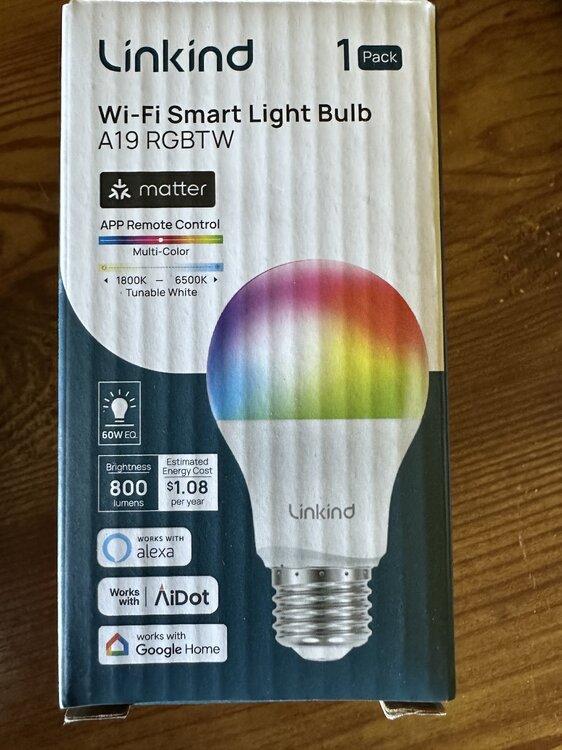

May 6May 6 After months of limited success with matter, I successfully added this bulb to Matter. These are inexpensive on Amazon
May 6May 6 Did you first add it to another platform, then use a share pin or QR code to add it to your eisy?
May 28May 28 Author I added it directly through UD mobile "add matter device with QR code". I don't have another platform to add with. Initially, I wasn't trying to add the bulb to the EISY. My non-device porch light burned out and I was out of regular bulbs. I remembered I had the Linkind bulb so I installed it until I could get to town for new regular bulbs. In the past I was unable to add the Linkind bulb and had given up on them. However, when I powered on the bulb it started flashing to indicate pairing mode. On a whim I tried to pair it using UD Mobile. I was very surprised when it paired and the color slider toggle icon appeared in the Home section.
