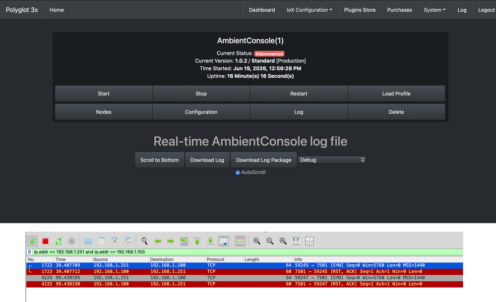

June 19Jun 19 Author I’ve gone through a full remove-and-reinstall cycle and wanted to summarize what I’ve done and what I’m seeing now.FYI: Just cleared all the logs from EISY (error and normal log). restarted then plugin from Polyglot V3. Also went to it’s debug log page and said it was running.Then waited to see packet sent from Ambient console to the eisy IP and the reply (image).Once saw packet, - Looked at Polyglot 3x - log / debug (nothing)- Looked at eisy event log, nothing of value- Looked at eisy error log - see attached, though doesn’t look like anything.System / versionsPG3x: 3.4.19IoX / eisy: 6.0.5PG3x status: ConnectedIoX status: ConnectedWhat I removed and reinstalledDeleted the AmbientConsole plugin from PG3x.Confirmed the eisy plugin slot list was empty afterward.Reinstalled AmbientConsole from PG3x purchases.Selected slot 1 during reinstall.Verified that PG3x put AmbientConsole back into slot 1 on eisy.Current AmbientConsole configurationIn PG3x, under the AmbientConsole plugin configuration:shortPoll = 60longPoll = 600Port = 7501Station Name = blankThese are the default values, and I have left them unchanged.Ambient Weather console configurationAmbient console is configured on the same LAN as eisy.Ambient console IP: 192.168.1.251eisy IP: 192.168.1.100Console is pointed to the eisy IPCustom server/path configured for the AmbientConsole setupI also tested a second port after the first one failed, but behavior was unchangedWhat I’m seeing in WiresharkI mirrored the traffic and filtered only the Ambient console and eisy conversation.What I see:Console initiates TCP to eisy on the configured port.eisy responds immediately with RST, ACK.I saw this behavior on both port 7501 and port 7502.I do not see the session proceeding to the point where actual weather payload data is accepted.What I’m seeing in logsAmbientConsole debug log shows no obvious errors.eisy logs show normal IoX/system traffic and plugin framework activity, but nothing that looks like a successful Ambient weather ingest.I do not see an error in the AmbientConsole log that explains the TCP reset.What this suggestsAt this point the LAN path is clearly working because the console reaches eisy and eisy responds. The issue appears to be on the eisy/plugin side where the TCP session is being refused before the weather data is accepted. ISY Error Log.v6.0.5__Fri 2026.06.19 12.58.31 PM.txt
June 19Jun 19 The plugin is running (or should be) on the eisy and the eisy's ip address in your case is 192.168.1.100 and will always be active when eisy powered up and running. From your screen shot of PG3x, the plugin is not running (status: Disconnected). The question that needs to be answered is why didn't the plugin start?You said you level the Station Name blank. What you enter here is what the node in the IoX node list will be named. By leaving it blank, the name will default to "unknown". Try this:With the log level set to debug, like what your screenshot is showingRestart (or Start) the plugin.The log file should start populatingIf the log doesn't start populating, that means PG3x was unable to start the plugin. The reason should show up in the PG3x log file so go click the "Log" button at the upper right of the screen. Depending on what plugins are running, this log may be capturing a lot of messages, so click the autoscroll to turn that off and then scroll back and look for error messages related to AmbientConsole.When the plugin is running, it will start a server listening on port 7501. When the plugin is not running, there's nothing listening on port 7501 so the connection is rejected.
June 19Jun 19 Author finally getting logs - see attached.Here is what Preplexity is coming back with:This log shows a mostly healthy PG3x startup and polling cycle, with one clear issue: repeated httpx connection error: Error: read ETIMEDOUT events around 07:12, 07:20, 07:36, 07:44, and 07:57, which suggests intermittent communication timeouts rather than a full outage.What looks normalPG3x starts cleanly, loads the SQLite database, finds the IoX controller, and reports the store is up to date.The node server AmbientConsole is repeatedly verified as installed correctly on IoX, and the /rest/profiles/ns/*/connection requests are returning 200 responses.Portal token refreshes are succeeding, and the UI reconnects after auth refreshes.What stands outThe repeated httpx connection error: Error: read ETIMEDOUT entries indicate a timeout when PG3x tries to talk to something over HTTP.There is also a udx401: Access denied (401) during several POST /auth attempts at 12:31, which points to failed portal authentication before later successful re-authentication.At 12:33:13 and 12:33:37, PG3x restarts twice in quick succession, which may have been intentional or could indicate a crash/restart cycle. pg3_6-19-2026_21732_PM.zip system_6-19-2026_21738_PM.zip
June 19Jun 19 The httpx read timeout error appears to be it trying to get connection info for slot 0. As far as I know, there is no slot 0. But UDI changes since I last worked on pg3x may be responsible for this. In any case, this is not related to your issue.The restart at 12:33:13 and what follows at 12:33:37 is strange. But again, not related to your issue.The log does show that the plugin was started last at 12:56:28 and that it started successfully. But then at 12:56:44 it logs:Is client running? /var/polyglot/pg3/ns/0021b9026000_1/logs/debug.log does not exist.So is the plugin still showing disconnected and its log file is empty? If that's the case, you'll have to submit a ticket to UDI as there's nothing in the PG3x log file that shows any issue with the plugin starting. They'll have to dig deeper into the system to figure out why the plugin isn't starting.
