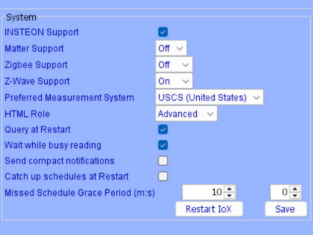

It's possible that power cycling your controller close to midnight is affecting the schedule. Try setting the power cycle at 12:30 am.
You can also try changing the last two lines in the configuration
