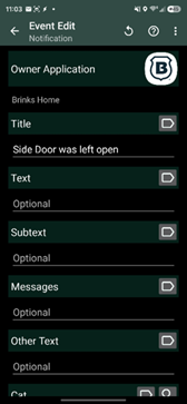

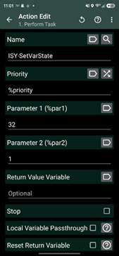

A beloved forum member created a great how-to on Tasker: http://wiki.universal-devices.com/index.php?title=ISY-99i_Series_INSTEON:Networking:Tasker. Once that was working, I set up profiles for the various activities. For example, I use "Side Door Open" plus whether it is raining or the AC has kicked on to remind me to close the door. (Precipitation and HVAC status are determined outside the ISY, then update the ISY.)
I used the previous ISY-SetVarState task to set the ISY flag.
After that, I set up the triggering event, a notification on my phone from the Brinks app (Brinks is my provider, but it’s managed on alarm.com). The title field is taken directly and exactly from the notification. If there is a timestamp, or variable text, an asterisk (*) acts as a wildcard. For example, I use 9* and Delivered, * as Title and Text, respectively, for USPS’ Informed Delivery of packages since specific information is included in each notification.
From there, all logic, including resetting the flag, is handled by ISY programs. I don’t use UD mobile, as I’m still on ISY994, so you will have to take it from here.
