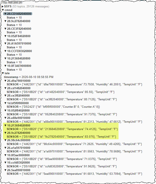

From the information above, I was able to modify the 1wire2mqtt python program to publish my 1wire data in a compatible format. Below is the results shown with MQTT Explorer.

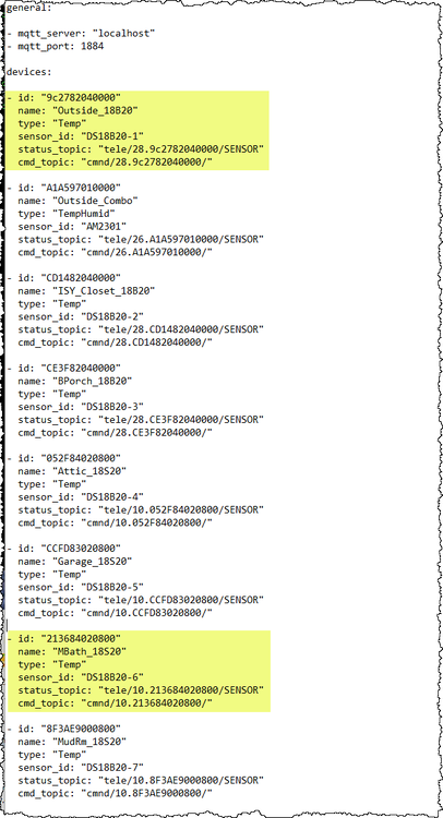

Next, I setup my MQTT plug-in's devfile to access the MQTT data. Below is the contents of my devfile.yaml file.

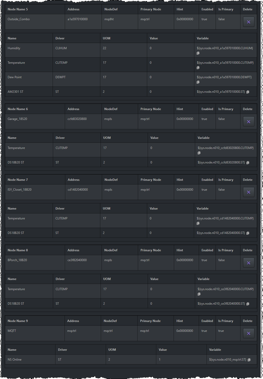

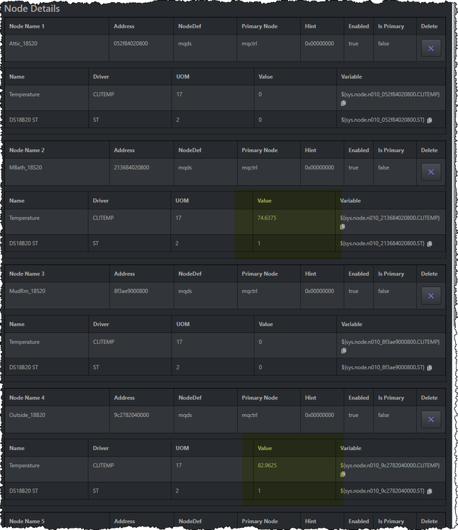

I have had some success. Two of the eight devices are working in the MQTT plug-in. Below are snapshots from the PG3 MQTT nodes screen.
PROBLEMS:
1. As you can see, two of the DS18B20 sensors are working (highlighted in yellow). One of these is a DS18B20 device and the other is the older DS18S20 device. (The DS18B20 has selectable 9 to 12-bit resolution where the DS18S20 is 9-bits only.) I modified my 1wire2mqtt python program to present both as DS18B20 devices. However, I cannot figure out why the other five DS18B20 type sensors are not working. I have examined the MQTT Explore output closely and cannot figure out what is wrong. Can you help?
2. The second problem is I am trying to access both temperature and humidity data from a DS2438 1wire device. I have manipulated the 1wire2mqtt python program to present these as AM2301 devices and am using the TempHumid type in my devfile.yaml. I have no idea if the MQTT data is in the expected format for the plug-in. If you could supply me with an example of what the MQTT data looks like for the TempHumid type like TriLife did for the Temp type, this would be a tremendous help?

  1. At first glance I do not see anything wrong, but there may be more in the logs. You may try deleting the nodes that are not working, so they can be remade. If you have been iteratively working on this, the node which was made in a previous attempt may be blocking the making of a new one. Two ways to do this, either stop the node then hit the 'x' on the right side in the node listing you attached above, or go nuclear and delete the whole node instance (make sure you have your yaml file safe). When you start the plugin again it will remake the nodes. If this does not work then I need the logs to go further.

I have had success on one of my two problems areas. The reason all but two of the Temp/DS18B20 type sensors did not work came down to capitalization used in the YAML file.
This does NOT work:
- id: "CE3F82040000"
type: "Temp"
sensor_id: "DS18B20-3"
status_topic: "tele/28.CE3F82040000/SENSOR"
cmd_topic: "cmnd/28.CE3F82040000/"
However, this does work:
- id: "ce3f82040000"
type: "Temp"
status_topic: "tele/28.ce3f82040000/SENSOR"
cmd_topic: "cmnd/28.ce3f82040000/"
I had the hex letters in the 1wire IDs capitalized when they needed to be lowercase. Now, all seven of my DS18B20 and DS18S20 sensors are reporting with the MQTT plug-in.

Based on the JSON sample you sent in your reply, I took a guess at the correct MQTT format. Below is an MQTT dump (using MQTT Explorer) of what I have tried today. The yellow highlighted lines are the DS2438 1wire sensors.
NOTE: I first tried a version where I had the Id info like for the DS18B20 sensors, but it did not work either.
Within my 1wire2mqtt python program, I replace the DS2438 device type with AM2301. Also, the DS2438 as used with NodeLink does not support reporting dewpoint. However, since dewpoint can be calculated if you have temperature and humidity, I added code to the 1wire2mqtt python script to calculate the dewpoint and report it for each sensor. The above MQTT format does NOT work for the TempHumid type in the MQTT plug-in.
