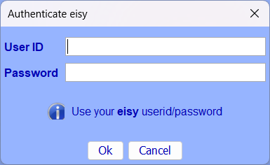

August 21Aug 21 7 minutes ago, stillwater said:I see that I have the username and password for the old ISY in my REST strings (though no port that I can see). do I need to change the username and password to the portal info? Or can I enter an alternate user/password somewhere in IoX?@Guy Lavoie Odd to have a setting you can't change.No, you should be able to use the old isy username and password, as long as they're replicated in the new eisy. If you log into admin console using that name and password, does it work? This has to be the url in ISY Finder with port 8443 in it. It prompts you for the eisy password: Edited August 21Aug 21 by Guy Lavoie
August 21Aug 21 Author No, connecting to port 8443 does not give any sort of connection. The eisy doesn't allow "admin" as a userid -- too short. I tried putting in adminadmin as User1 via the file menu in the admin console, trying to put in the URL in the finder (ip adress/desc:8443) as you suggested inists that the userid be an email address. Using the adminadmin as userid in REST did not work

August 21Aug 21 @stillwater It's asking for your portal user name and passwordIf you want to use your previous name and password add the following URL line in IoX Launcher:https://eisy.local:8443/desc then click save
