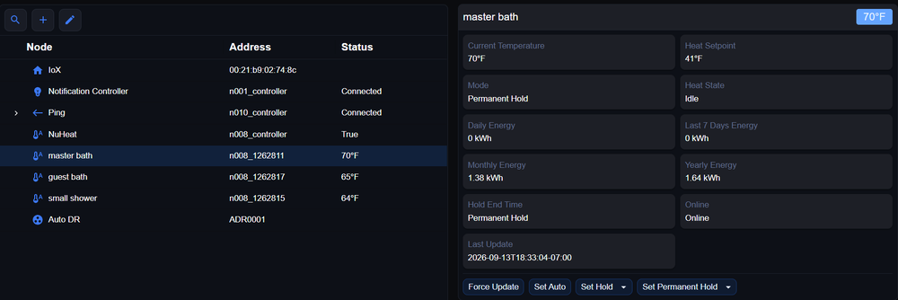

September 14Sep 14 I added a new node server to test in the beta (non-production) store - can you give it a tryit is called NuHeat_v2You will need to redo the programs as I may have changed some values - for sure the commands are changedYour should only need to login to your nuheat account once requested (after pressing Authenticate during start up) and then accept the different scopes. I believe this is sufficient, but cannot test if the credentials I got only cover my account of if all users can use it (I hope this is the case) Once it is working - I'll do a full release. I am working with UDI to see if they can move licenses from the old to the new plugin Edited September 15Sep 15 by Panda88
September 15Sep 15 Author I still have an ISY 994i and my Node Servers run on a POLISY that connects to the ISY994i. Looking at PG3 I see the nodes and their values and that seems to be working fine, but the nodes in the ISY 994i are empty, ie it creates the Controller Node and the Main Node for the thermostat in the ISY994i but they have no values. Will pull the log when I get home later tonight and PM you.
September 15Sep 15 @bpwwer Do you know what could be causing this? Is the PG3x/udi_interface version too new - I just made the version I currently use the requirement@jwagner010 Just to be 100% sure - you were able to press authenticate and then log into your account and then you see data in the Polisy with same values as the app - can you also change temps etc? If that is the case, we just need to understand why you do nto see the same in the ISY994. BTW - is there any special reason for not moving to run on the polisy? Edited September 15Sep 15 by Panda88
September 15Sep 15 Author Yes was able to authenticate. Just sent you a PM with log and screenshots. Cannot change temp as there is no temp setting in the node.Re: Moving to POLISY, I have a large Z-wave base (already installed on ISY994i) and do plan to move to EISY eventually, but I have been putting it off as I have a very large amount of programs also and I know when I upgrade it will take me a few days (week) to get it all functioning properly and I just dont have the time, so looking to migrate (hopefully) at the end of 2027. Edited September 15Sep 15 by jwagner010
September 15Sep 15 @jwagner010 Are you running PG3 or PG3x on the Polisy? I know that none of the changes being made for eisy-ui are being tested on PG3. I'm also pretty sure that nothing is being tested with an ISY994i and it's firmware version. They aren't intentionally trying to break that setup but it could happen.My current plug-in development environment is still PG3 based so I can test on that if needed.
September 15Sep 15 Author POLISY: PG3x Version 3.4.18 (front end version: 3.4.18)ISY 994i: IOX 5.3.4PS. all other Node Servers work fine and the nodes show correctly in the Admin ConsolePPS. When I change the Heat Seat Point on the thermostat either manually at the thermostat or via the NuHeat app the setpoint value in the PG3x Node server changes. It just doesn't show in the admin console, the two main nodes show in the Admin console but each of them is empty. Edited September 15Sep 15 by jwagner010
September 15Sep 15 You can set the temp using perment hold (I guess I should rename it to permanet set) - but it looks like you do nto see that in UDmobile I am using dynamic parameters in this node, and I wonder if it could be caused by that - it does require a newer version of the udi_interface
