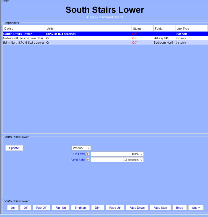

How do you run a scene from the admin console. I dont see the option when I right click the scene. I only see scene test

When I click on a scene (not right click) the main part of the page has buttons along the bottom including On OFF FastOff and FastOn. That's what I meant by running the scene from the admin console. Scene test does turn the scene on and then off and reports.
