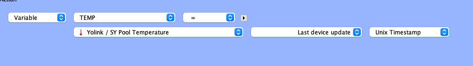

OK, I was trying to figure out how to tell if the last device update for a certain device was older than a certain amount of time. I know I could accomplish something like that by having each event start a program that waited some amount of time but I got to thinking, why can't I just check the device last update and compare it to either the system time or for example a variable unix timestamp.
I don't think this works even though you can create an if statement in a program that looks like it should work:
LastUpdate - [ID 00AF][Parent 0010]
If
'YoLink / Motion Crossroad' Last device update < '$On_Minutes Unix Timestamp'
Any ideas? I want for example to run a program at 8 am that will tell me if a device has not had an update in the last 24 hours.
