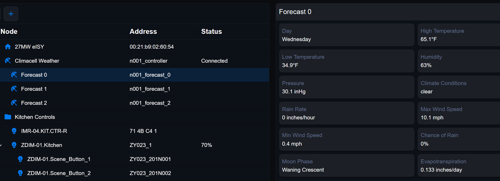

Can you still see the Climacell nodes with those values listed under the Nodes menu in eisy-ui? If you don't or you get an error when selecting the node, the plugin didn't migrate correctly.
If the node looks correct this is probably a question for @bmercier

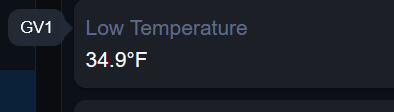

Thanks Bob, here is what I see for one of the nodes, "Forecast 0". I obviously see all of the values on the right, and if I hover over something like Low Temperature, I see parameter name like "GV1". But nothing like "${sys.node.n001_forecast_0.GV1}" as I see under the PG3x instance.
Since you see all the node's values, it appears the migration was successful.
The "${sys.node.n001_forecast_0.GV1}" is the way to identify that node value in messages/notifications. What it's basically saying is that you want to substitute the value of node n_001_forecast_0 GV1 value into the message. From your screen shots, everything looks correct.
