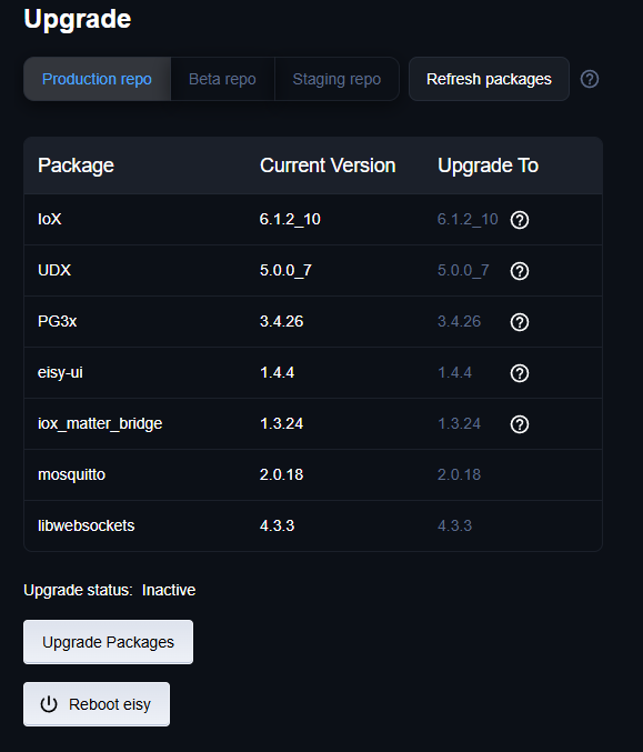

October 16Oct 16 Hello,I just fully upgraded my firmware and tried to access the new eisy ui. I can get to it from the http and the https, but when I try to login using same credentials I use to login to the portal it gives error (Error Logging in to plugins service).Please advise what to do now.I can still access from my phone and from IoX launcher.
October 16Oct 16 see https://forum.universal-devices.com/topic/47255-error-logging-into-eisy-ui/#comment-408299

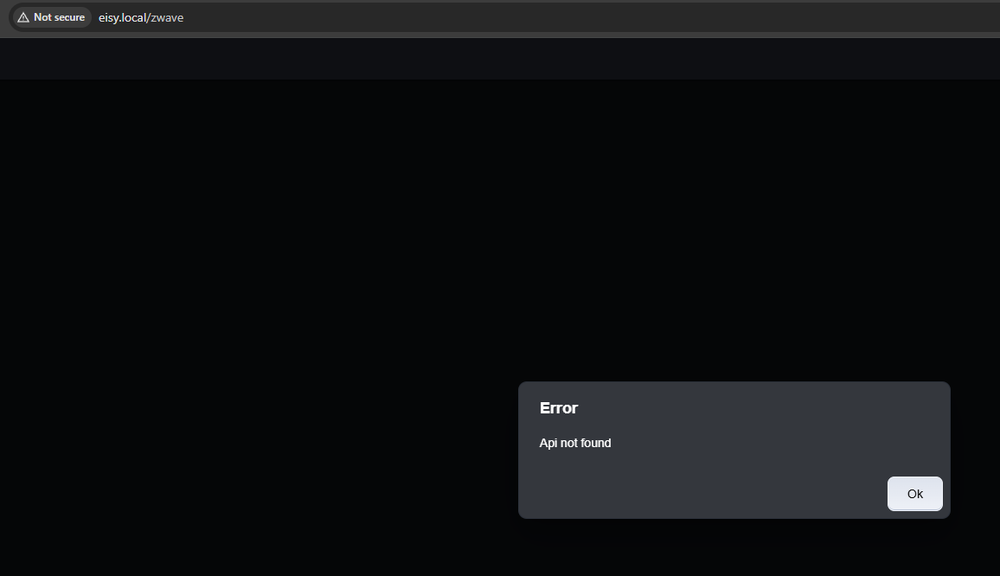

October 16Oct 16 Author Thanks Javi,it got in but gave this error: (Error: Api not found)it gave this for nodes and plug ins. So i can't see any of my devices.

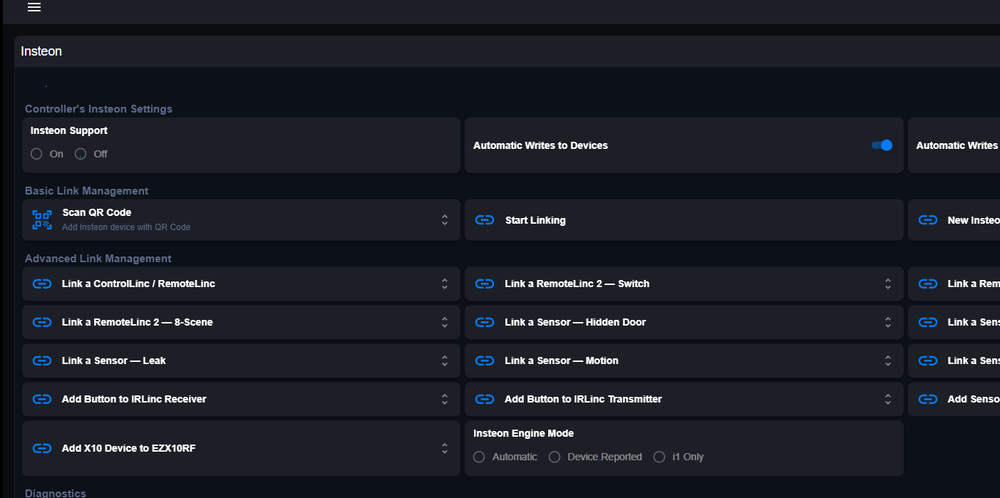

October 16Oct 16 Author Also under insteon, it keep on loading foreverZ wave, API not foundAm i missing something that needs to be installed?from what i see here everything is up to date
October 16Oct 16 Before ssh try upgrade packages again + wait 10 min.If that does not work, ssh to eisy: ssh admin@ipaddress.Then a sinlge command (below), wait a few seconds then check if the page loads.sudo service isy restartsudo service eisy-ui restartsudo service udx restart
