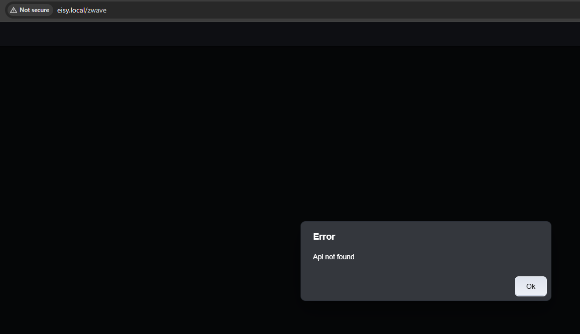

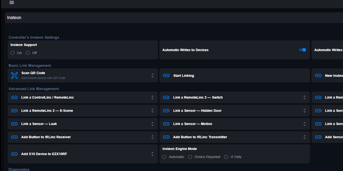

  3. Also under insteon, it keep on loading forever Z wave, API not found Am i missing something that needs to be installed? from what i see here everything is up to date
  4. Thanks Javi, it got in but gave this error: (Error: Api not found) it gave this for nodes and plug ins. So i can't see any of my devices.
