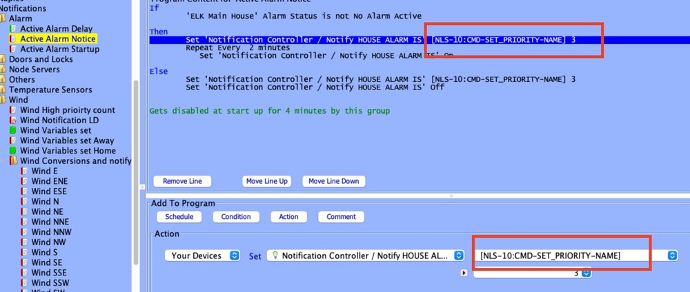

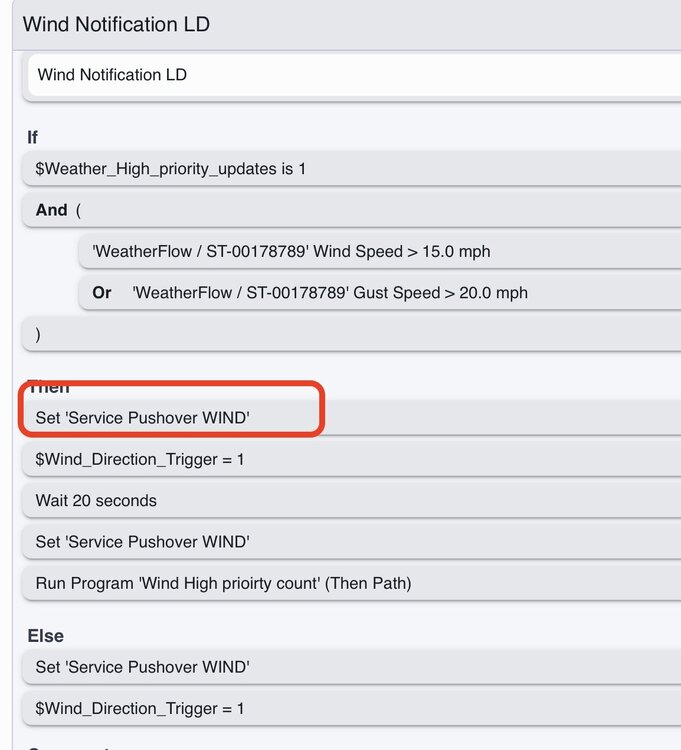

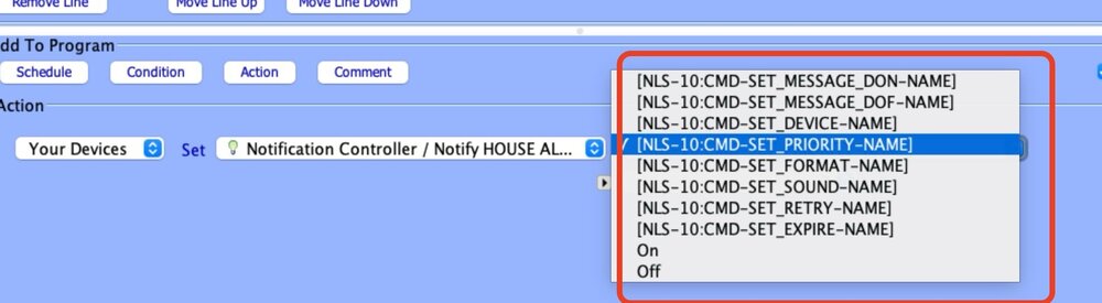

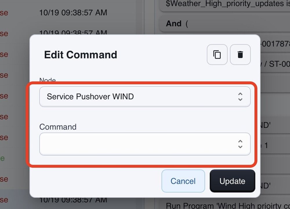

@Jimbo.Automates I migrated notificaitons form pgx3 to eisy.
Now my programs are not allowing me to edit the lines, or the lines have strange input.
See first FOUR screenshots below for both AC and Eisy UI

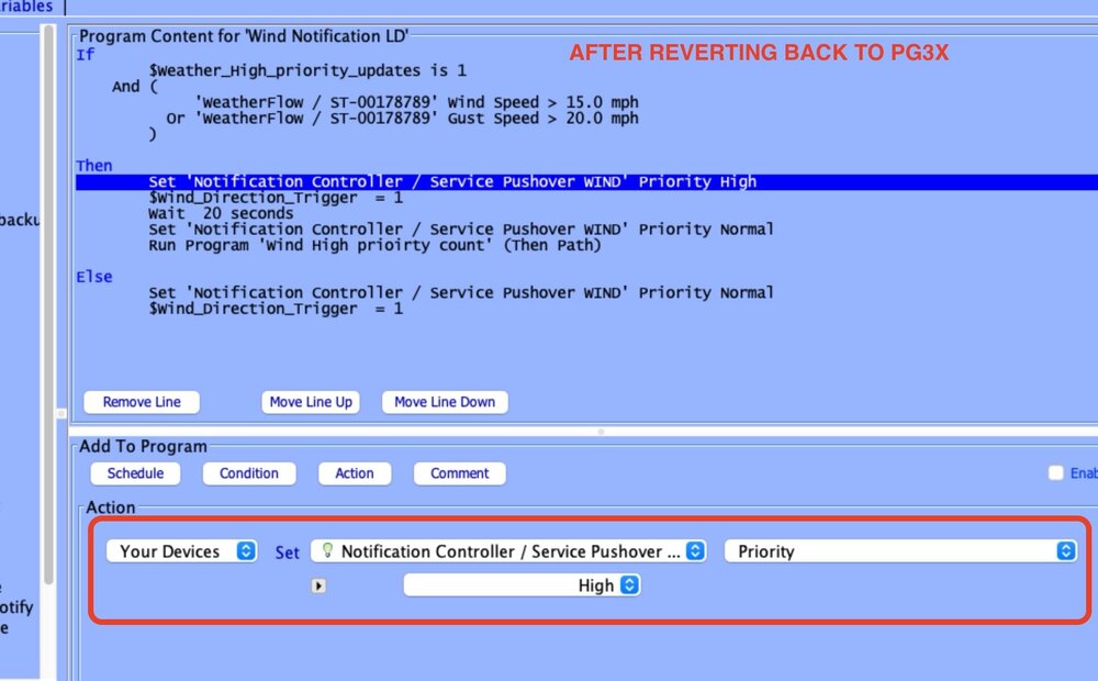

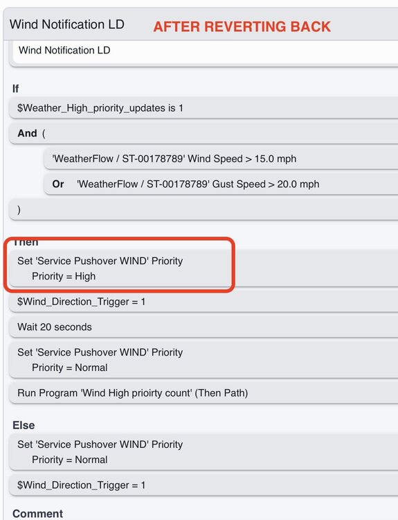

After reverting back to PGX3, everything is back to normal. See last two screenshots.
Thanks.

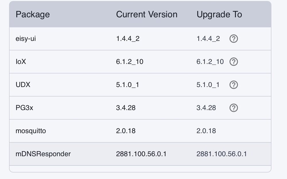

Solved with lates versions:
