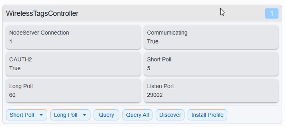

Since migrating PG3 nodeservers to the eisy.ui plugins, my Wireless Tag devices have not reported to the eisy plugin. The Tag Manager is present and appears to be authorized:
When the Wireless Tab nodeserver was installed in PG3, there was a Monitor Tag function that had to be enabled so the tags would show up in IoX. I don't find a similar ability in the eisy plugin.
Suggestions, please.

All Nodes/devices are showing up under the plugin in Polygot 3x
  • polygot 3x wireless plugin display eight nodes detected but node values are not updating.
  • easy-ui no nodes showing up
  • eisy-ui node list nothing under wireless tag controller
  • in admin console only see wireless tag controller no devices
Wireless tags appeared after updating eisy.ui to ver 1.4.6. More in this post.
