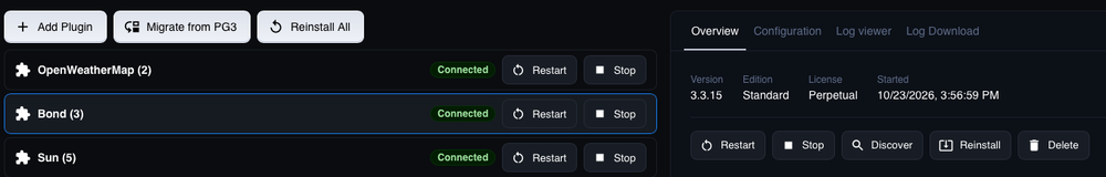

I migrated my Bond Bridge plugin today into eisyui and at first test nothing appears to be responsive when I go to the node panel and manually toggle lights or turn on the fan. When I look at the log file it appears to be using the correct device IDs... example here for a few different trys for different devices...

The node addresses shown in this log grab are correct for the device I was trying to enable or toggle and the Token for the Bridge itself is verified as correct in the configuration tab. The Bond Bridge does show as connecting in eisyui and I have tried to restart the plugin with still always getting the same error on the node addresses not existing.
