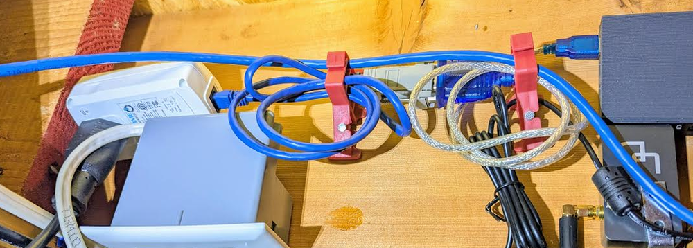

16 hours ago16 hr I have a functioning EISY system with a 2413S PLM. The upgrade website indicates that I need a serial PLM kit:https://www.universal-devices.com/product/serial-plm-kit/I already have some type of cable system to the PLM that is working: Do I need to get the serial PLM kit?
15 hours ago15 hr It would seem "No" you don't need the Serial PLM kit.You may already be using a USB-to-Serial adapter from elsewhere, and if it's working and your PLM is happy, that's fine. You state that you have a working system, and any upgrades from here on should be software-only for you.(it's hard to be completely certain from your photo and wiring, but it seems your translucent-blue USB plug and associated sliver-braided-clear cable at the top right of your photo is a USB-to-serial adapter. There are many such adapters floating around, and it's good if you have one that is working. From the blue DB-connector, you have what seems to be a beige DB-connector to RJ-45 adapter. If this is working, and provides your PLM with the needed signals, then it would seem you are good-to-go). Edited 15 hours ago15 hr by GPritchard
10 hours ago10 hr Author Thank you. Yeah, that is where I put the system when it was having a hard time with Zwave. This puts it in the middle of the house, so it works better.The system does work (until I tried to upgrade the software anyway).I'll keep it as is.

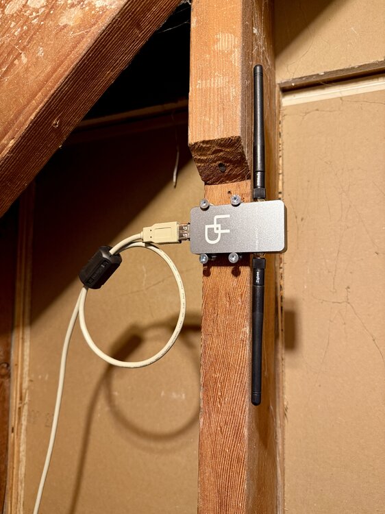

9 hours ago9 hr Straying off-topic here 😁I wonder if your Z-Wave coverage would be improved if you remote your UD Dongle?I found that was the case: I used a USB-A male to USB-A female extension cable, about 5ft long, and it seems to work fine:
