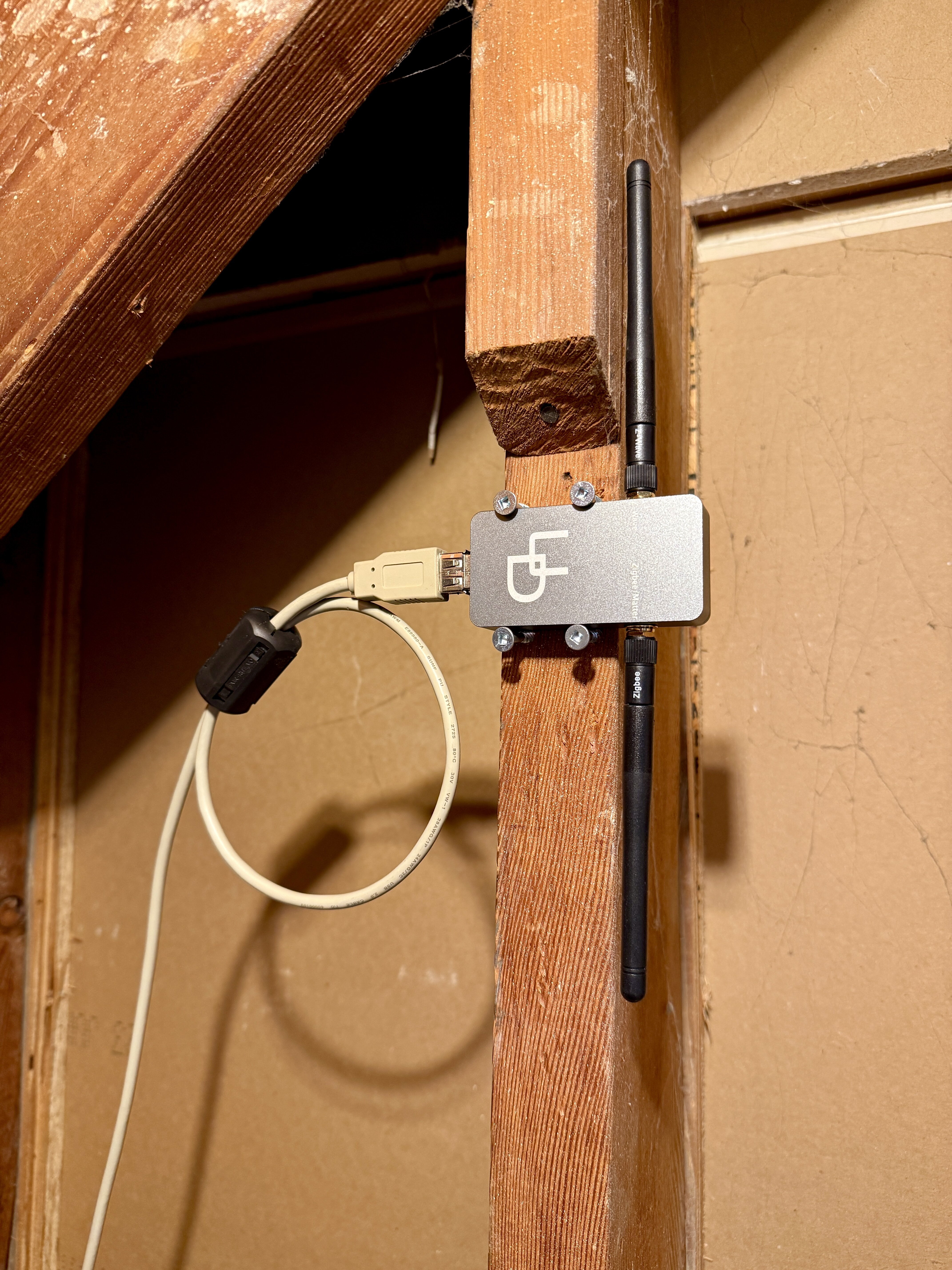

  8. Straying off-topic here 😁 I wonder if your Z-Wave coverage would be improved if you remote your UD Dongle? I found that was the case: I used a USB-A male to USB-A female extension cable, about 5ft long, and it seems to work fine:
