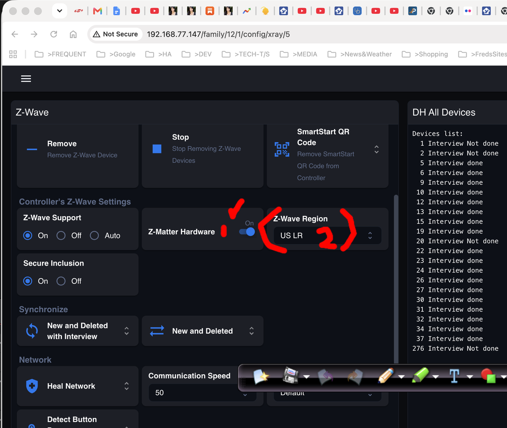

The biggest indication of LR operation is the node number. It should start at 256. I don't know what your Zwave dongle is, I have the ZMatter, so node names are prefixed with ZY. My first (and only) LR device thus has node name ZY256.
But you would have to have included it as a LR device, with some setting up. Notice how the Zwave setup screen below shows the Z-Wave Region as US LR:

Looks like I'm out to lunch on a whole bunch of stuff here, because my node does not start above 256, and I don't see anywhere to see the ZMatter version. Thought it was somewhat up to date, but obviously ZMatter is another animal. So I have to hook it up to a Windows device to upgrade it?

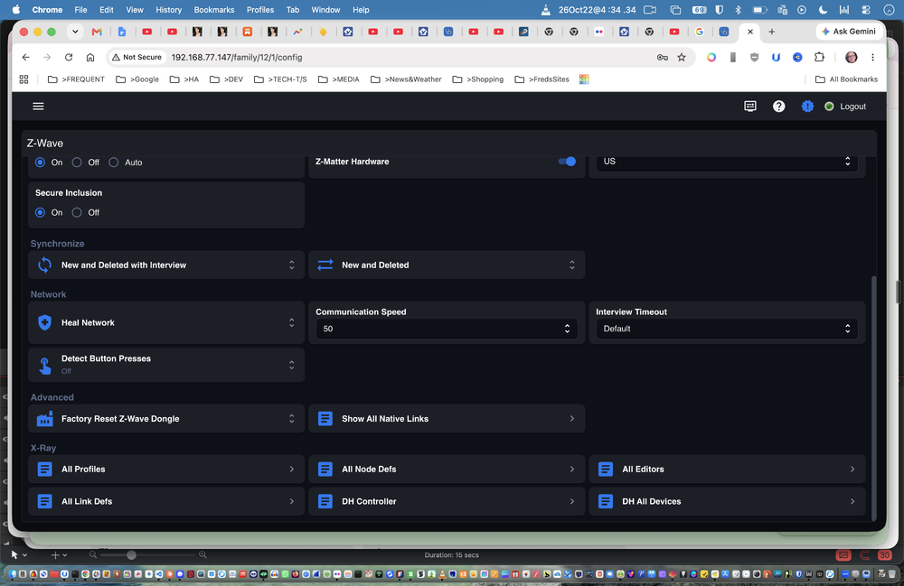

Yes. If it was never updated, your ZMatter dongle is very likely at firmware 7.32. You can see the version in eisy-ui by going into the Z-Wave menu and clicking on X-Ray -> DH Controller. Here's mine after the update, see how the APIVersion = "07.46"

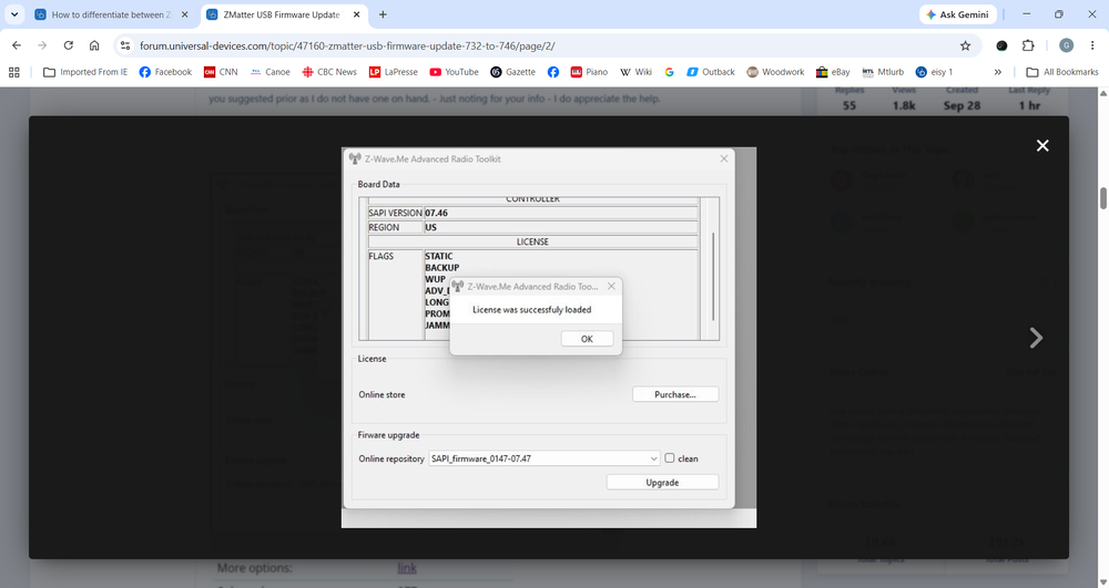

Thanks, all y'all, I was able to upgrade using my Mac. I stopped at 7.45, maybe I'll go to 7.46 at some point.

After a few heart-stopping moments and being up till 3 am, I finally got completely upgraded on everything, and it's working this morning after a few reboots and holding my tongue just the right way. I finally upgraded to 7.46 because it was timing out trying to SmartStart add the ZooZ 800LR switch, but it's still timing out.

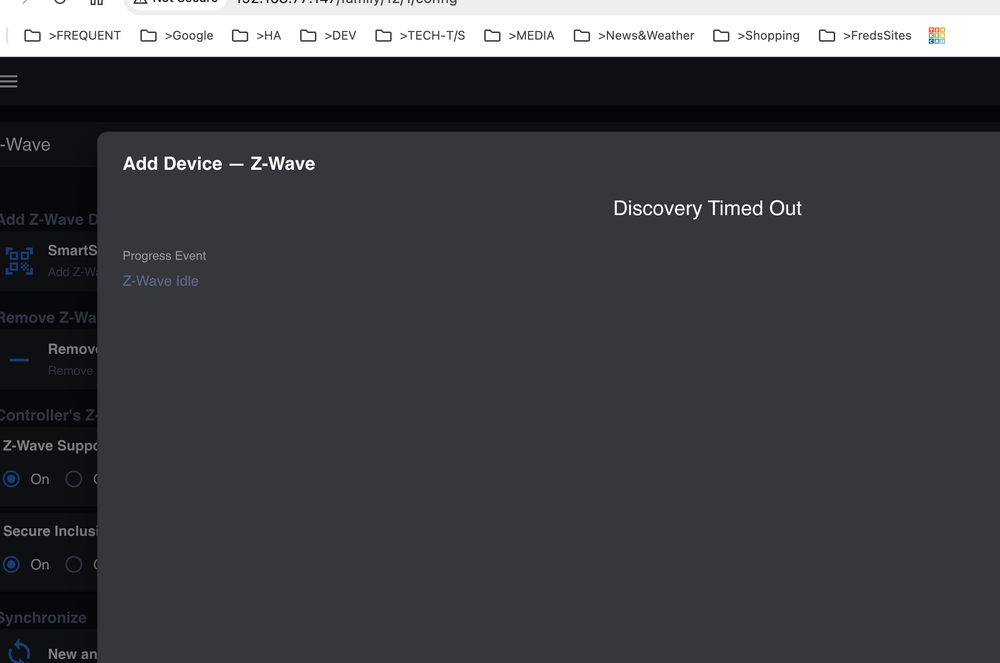

(I did it successfully, but still same timeout... "Discovery Timed Out")
I'm quite sure it's actually seeing it, but just not finishing the interview.

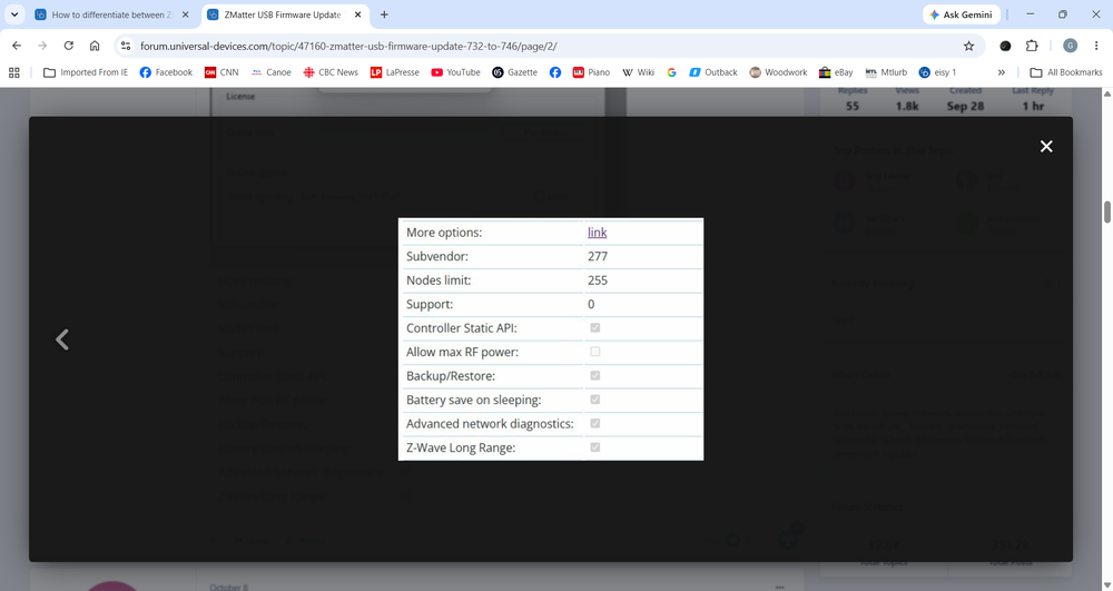

Ok, just to make sure nothing got looked over. The Long Range box was checked after you finished the dongle upgrade process, right?
Did you end up needing to use the Zsniffer tool to enable it?
I need to be a little bit careful answering this because I'm not sure. It seemed pretty smooth, and I didn't have to answer anything about license or use ZSniffer to get these options that I've shown in the screenshot, is that what you mean?

No, I meant in the dongle upgrade screen, that I posted above. Is the Z-wave Long Range box checked?
Ah sorry, I hadn't seen the video (I was outside just reading your post on my phone). Looks like it's set ok.

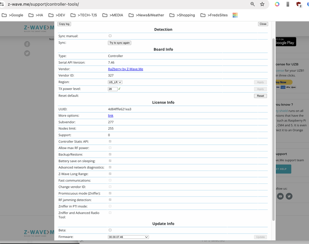

I didn't have to check off the long-range option...
The only difference left compared to mine is that I also turned on the fast communications feature. You could give that a try.

Followed this to a T, and it failed the same way again. I have a screenflow and logs attached.
