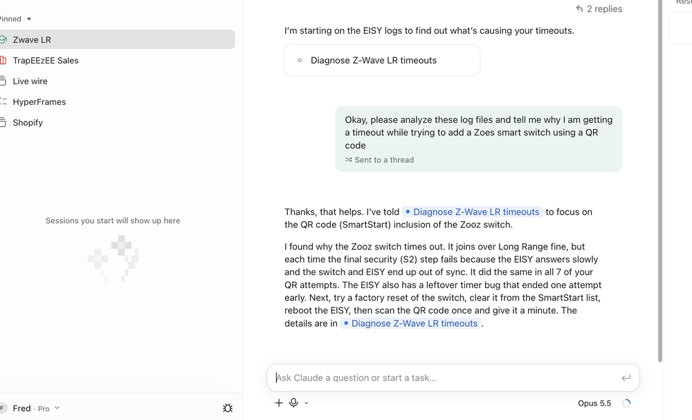

[2026-10-23 19:10:52.979] [D] [...] Security S2 inclusion timeout event
[2026-10-23 19:10:52.979] [W] [...] Node 300:0 CC SecurityS2: Security S2 key negociation with node 300 failed, KEX fail reason: Unknown Security S2 KEX failure reason (0)
[2026-10-23 19:10:53.011] [I] [...] Node 300:0 CC SecurityS2: SmartStart inclusion failed, trying to remove this device

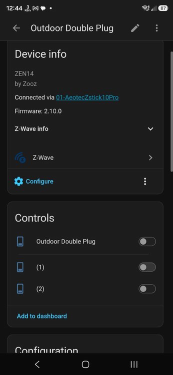

ZooZ double plug ZOOZ model Zen14 800LR
Search: USA link: outdoor double plug ZOOZ model Zen14 800LR

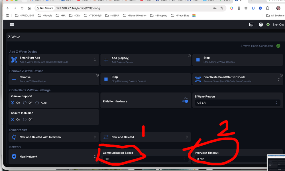

7 hours ago, johnstonf said:

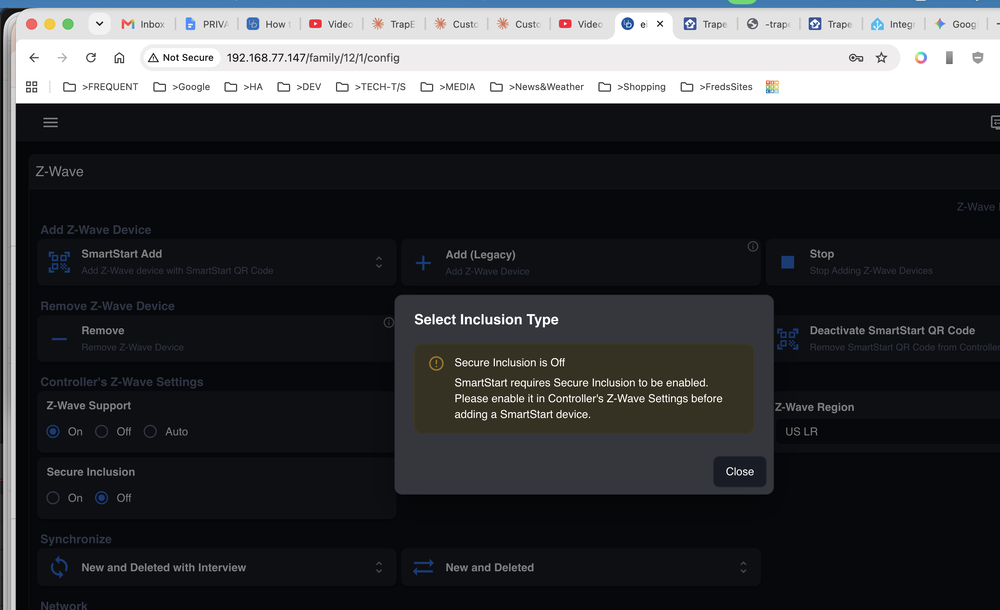

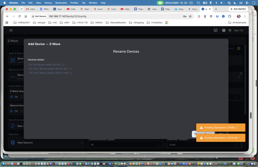

I didn't have to check off the long-range option...
The parameters seem to be inaccessible and grayed out, how did you do it?

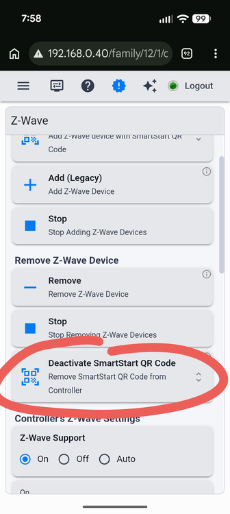

1 hour ago, Javi said:
Also for some reason the deice has conflicting is Long Range is/isNot enabled logs. LongRange and isLR.
The profile may need to be removed from eisy prior to adding again. So the steps would be remove profile from ZWave page which will present QR Scan, Factory Reset Z-Wave Device, then same steps to add again. Download log on failure
What is the procedure to remove the profile?
