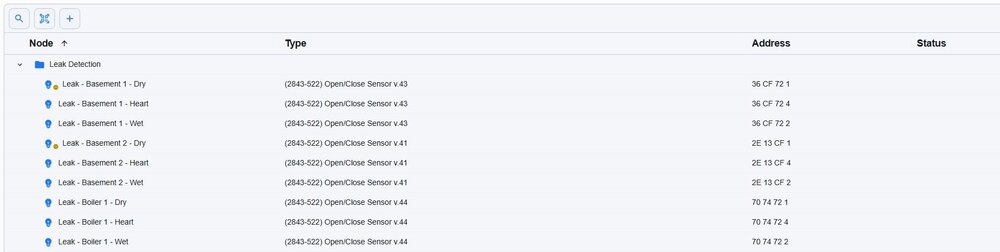

I finally decided to dive into EISY-UI last night and I noticed that all my Insteon 2852 Leak Sensors are being incorrectly reported as 2843 Open/Close Sensors in EISY-UI. The Admin Console reports their type correctly.
I tried deleting a leak sensor, factory resetting it and re-adding it, but that did not change how EISY-UI reports their type. I even tried rebooting the EISY. No change.
In preparation for me getting to know EISY-UI, I upgraded to the latest release so I can't say if this behavior is recent or has existed all along. It doesn't appear to be causing any issues with the leak sensors ability to report status, and all functionality seems to be working fine. This appears to be more cosmetic than functional. But it would be nice if EISY-UI would display the correct sensor type.
Let me know if anyone has a suggestion I didn't try.

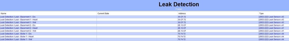

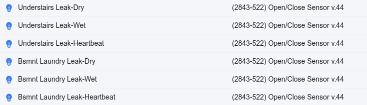

I've included 2 attachments showing 3 of my water sensors and their addresses and types. The Admin Console correctly reports these devices as "(2852-222) Leak Sensor v.4x" while EISY-UI incorrectly reports them as "2843-522 Open/Close Sensor v.4x".

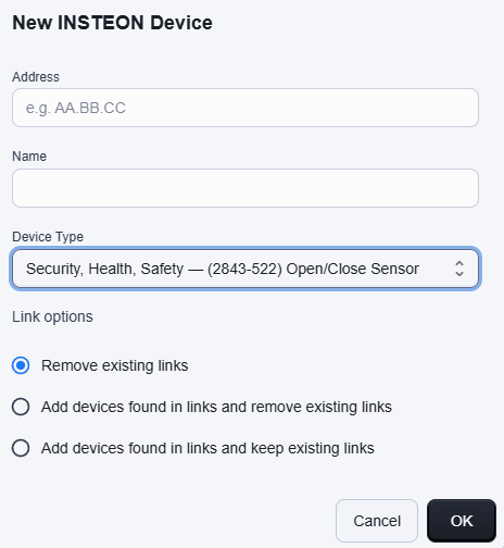

On a side note, I did notice that in the Insteon section under "Protocols", there is a specific option to add a Leak Sensor, but oddly it defaults the type to the Open/Close Sensor rather than the correct Leak Sensor type. This is likely just an opportunity to tighten up the code and default to the correct 2852 Leak Sensor type. Below shows the default Device Type when adding a Leak Sensor in EISY-UI:

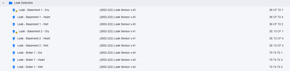

My leak sensors are now correctly showing in EISY-UI as leak sensors! The update to EISY-UI 1.4.6 fixed the issue!
Javi, thanks for your help!
