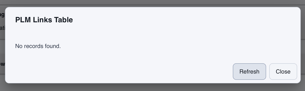

September 26Sep 26 I tried Show PLM Links Table on eisy-ui (beta 1.3.11_1), but all I see is this ... should it be displaying actual data or are my links really hosed?

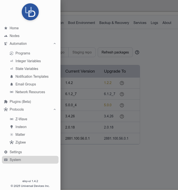

Tuesday at 01:09 PM4 days Where do you guys even see the options for PLM or Device links? I don't see anything in eisy-ui like I'm used-to in the java Admin Console:
Tuesday at 01:56 PM4 days 45 minutes ago, GPritchard said:Where do you guys even see the options for PLM or Device links? I don't see anything in eisy-ui like I'm used-to in the java Admin Console:Menu > Protocols > Insteon. Or Right Click Device > Configuration

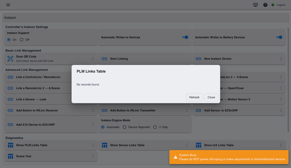

Tuesday at 04:02 PM4 days Thanks, Javi - there it is!Weirdly, my PLM links shows empty! Even if I use Advanced -> Restore Modem (PLM). Always empty. But the Admin Console (Java) shows PLM links. Edited Tuesday at 04:06 PM4 days by GPritchard
Tuesday at 06:35 PM4 days I just checked my eisy... with eisy-ui show PLM links reports "no records found" -- But it also says system busy and event viewer shows eisy receiving something like 870 lines, presumably from the PLM. In fact if I open the admin console it shows the PLM links table scrolling on the screen in response to the eisy-ui initiated process. Clearly something is amiss with eisy-ui display. Otherwise system is behaving normally. This is with eisy-ui 1.4.3_1 and IoX 6.1.2_10.
Tuesday at 10:11 PM4 days Author On 9/26/2026 at 7:27 PM, Techman said:@dwengrovitzI'm runing 1.3.11_1 and i'm able to view both the device and PLM link tables in eisy-uiDid you try rebooting the eisyYes - I've rebooted multiple times. The problem still exists for me on eisy-ui beta 1.4.2. The system looks like it's busy doing something, but no data ever gets displayed. See screenshot below ... eventually, the orange box goes away and the white remains, with no link data displayed. Edited Tuesday at 10:11 PM4 days by dwengrovitz

Wednesday at 04:22 PM3 days @Javi I am using local connection -- on same LAN. login using eisy.local. It seems to run the query but almost before the query would have time to show any data the box says no records found.
