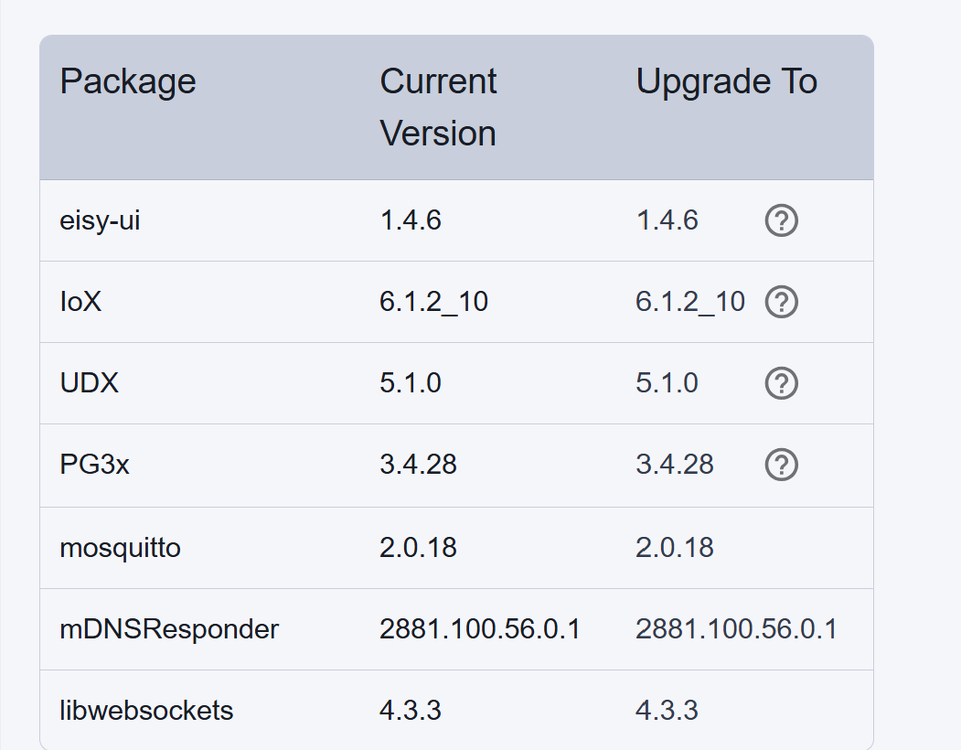

October 24Oct 24 For me, I don't get that Error 500:Running versions appear the same as yours (I did reboot following each upgrade): Edited October 24Oct 24 by GPritchard

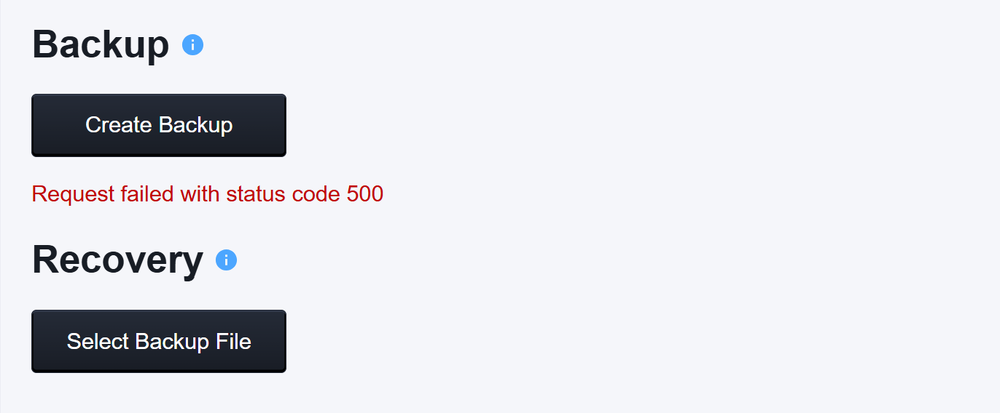

October 24Oct 24 Author This just started. Worked fine a couple of days ago. Did try a hard re-start, no effect.

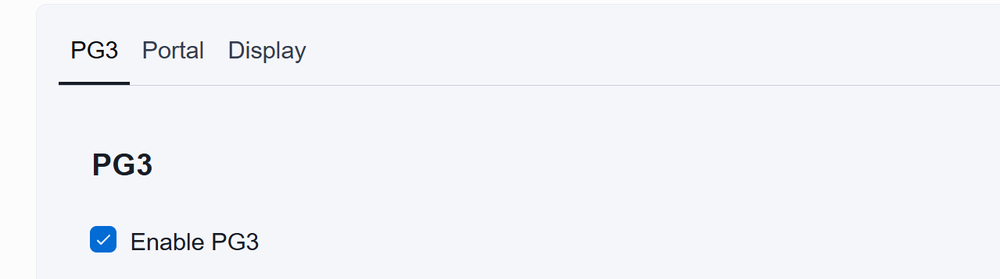

October 24Oct 24 Author Figured it out, if you disable PG3 in eisy-ui. backup will not work. If enable works.
October 24Oct 24 Just now, EricBarish said:Figured it out, if you disable PG3 in eisy-ui. backup will not work. If enable works.Very interesting. Is this something that is really reproductible.If so, replicate the error and check what error you are getting in the eisy-ui logs.You can also open a ticket and send your log after replicating this error.

November 4Nov 4 I noticed this error 500 a couple of days ago, with eisy=ui 1.4.8.I just upgraded to 1.4.9 this morning and it's still happening.

Sunday at 08:43 PM5 days Sorry to Post here but it appeared issue for others has bee resolved.Mine just started throwing error 500 after starting a backup in eisy.pg3 appears in place, ai is 2.2.3 and on the latest staging. I do however vaguely remember deleting pg3, then brought it back into ui.Any suggestions?Thanks!-Tim

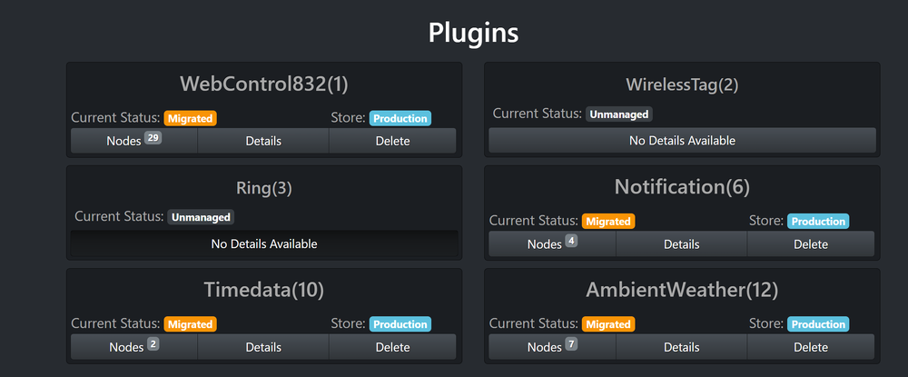

Sunday at 09:49 PM5 days 51 minutes ago, DennisC said:Yes, UD is aware, as I have been working with them on this. Be patient, they should have something soon.Thank you, not sure if this is the bug they are working on, but maybe it is. Once I deleted the last plugin I installed, both of my eisy's will now perform a backup from the stock system page in eisy.
