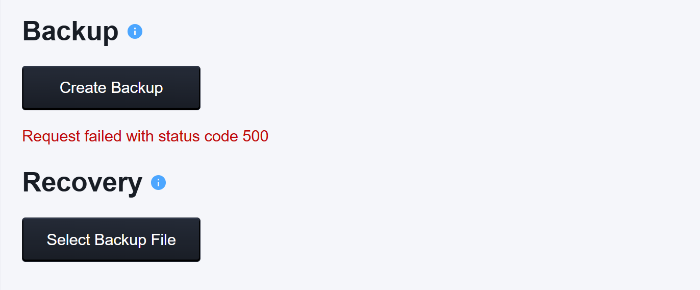

500 error on backup attempt

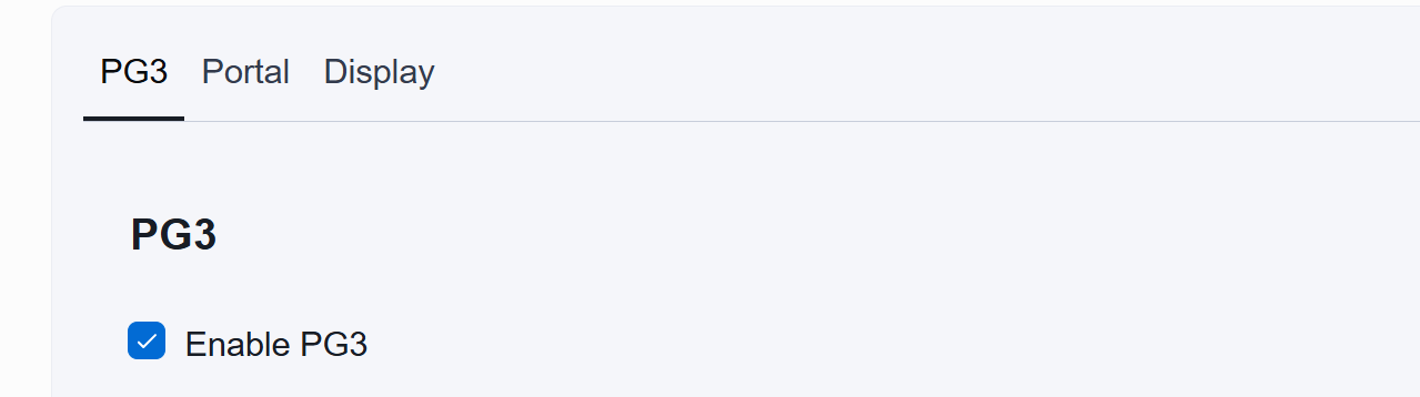

Yes it is reproductible. Here is the section with the error codes, looks like something to do with the plugins. All plugs have been moved from PG3 and are now working, but not deleted in PG3. this error with PG3 disabled on backup try. 2026-10-24 12:02:24 [error] web: Backup failed: Error: socket hang up at AxiosError.from (/var/eisyui/node_modules/axios/dist/node/axios.cjs:874:24) at RedirectableRequest.handleRequestError (/var/eisyui/node_modules/axios/dist/node/axios.cjs:3299:25) at RedirectableRequest.emit (node:events:509:28) at eventHandlers.<computed> (/var/eisyui/node_modules/follow-redirects/index.js:49:24) at ClientRequest.emit (node:events:509:28) at emitErrorEvent (node:_http_client:109:11) at Socket.socketOnEnd (node:_http_client:617:5) at Socket.emit (node:events:521:24) at endReadableNT (node:internal/streams/readable:1735:12) at process.processTicksAndRejections (node:internal/process/task_queues:90:21) at Axios.request (/var/eisyui/node_modules/axios/dist/node/axios.cjs:4339:41) at process.processTicksAndRejections (node:internal/process/task_queues:104:5) at async eisyBackup (/var/eisyui/dist/server/services/system.js:600:33) at async /var/eisyui/dist/server/routes/api/authenticated/system.js:86:18 2026-10-24 12:02:24 [error] web: Error with API request to GET /api/system/backup/create: socket hang up eisy-logs-2026-10-24T16-04-30.zip
This just started. Worked fine a couple of days ago. Did try a hard re-start, no effect.

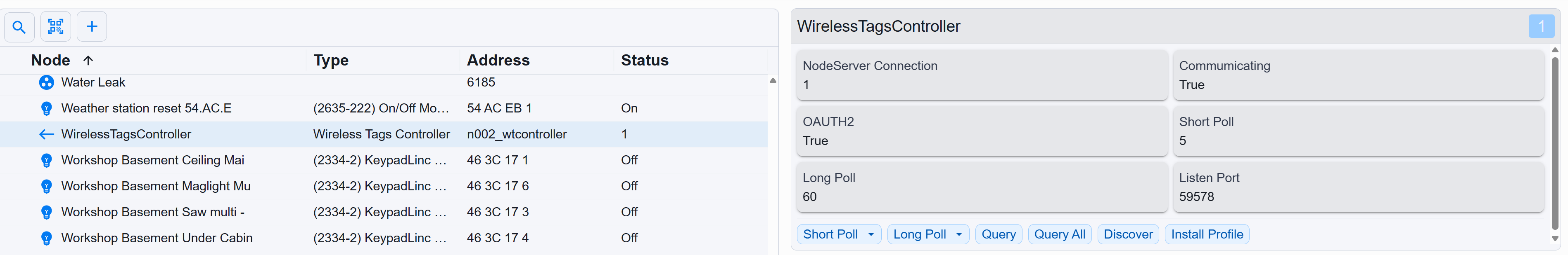

Add another plugin problem Wireless sensors

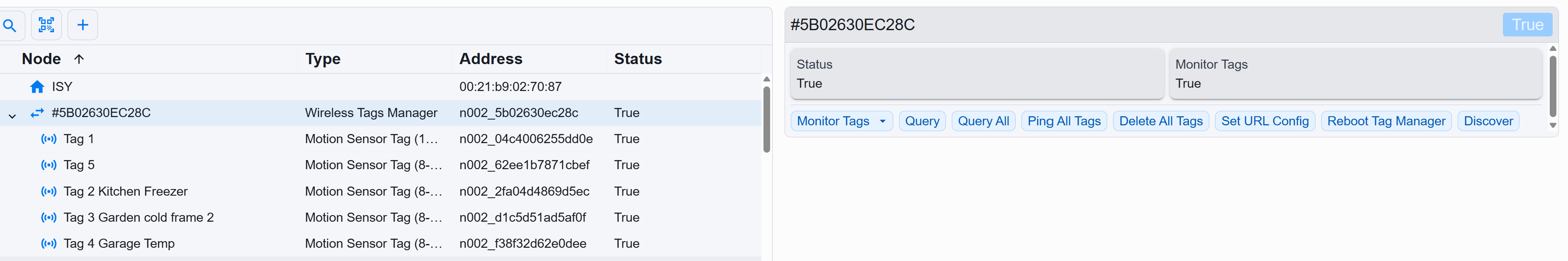

Well finally fixed the problem and have the nodes for the wirelesstags working First after installing or migrating your plugin, ignore this in the node list Wireless TagController Now go look at the top of your node list for some thing like this ( no idea were this name came from) Node Name Type #5B02630EC28c Wireless Tags Manager If you click on this node you will get the correct panel on the right. In this panel go to monitor tags and set value to true. Nodes will appear under the #5B202630C28 No idea why two different node names show up for the wirelessplug in, the one labeled wireless tagsController does nothing. Found this by pure chance, looking at the top of the node list and wonder what this strange node name was.
Have tried many things to get this plugin to shows it nodes. Reinstalled, hard reboot of eisy and others. have latest Beta updates installed. Nothing worked so far. In reading the read-me for this pluging by JimBoca it stated the following after the tag manger node shows up, "The Tag Manager node created in the ISY has a "Monitor Tags" option, which by default is disabled in case you have multiple ISY's. It should only be enabled on the ISY that is on the same LAN as the Tag Manager. When this option is enabled, the nodeserver updates all the Tag URL's so any updates are pushed to the REST server. " This option is not showing up in the wirelesstag controler options after a new install in eisy-ie. Has anyone been able to get this node server to work with the new Eisy-ei? I can get the wireless tags working in Home-asst and send the data to eisy-ie using variables for the programs needing it but holding off for now.
Moved wireless sensors to plugins in eisy-ui. The controller shows up but the sensors themself's do not show up under the controller.
Tags missing in Wireless Tags plugin
All Nodes/devices are showing up under the plugin in Polygot 3x polygot 3x wireless plugin display eight nodes detected but node values are not updating. easy-ui no nodes showing up eisy-ui node list nothing under wireless tag controller in admin console only see wireless tag controller no devices
Checking mine same, Only see the control page, not the devices. Devices are showing up in my.wirelesstag.net tried stopping and restating pllugin no effect.

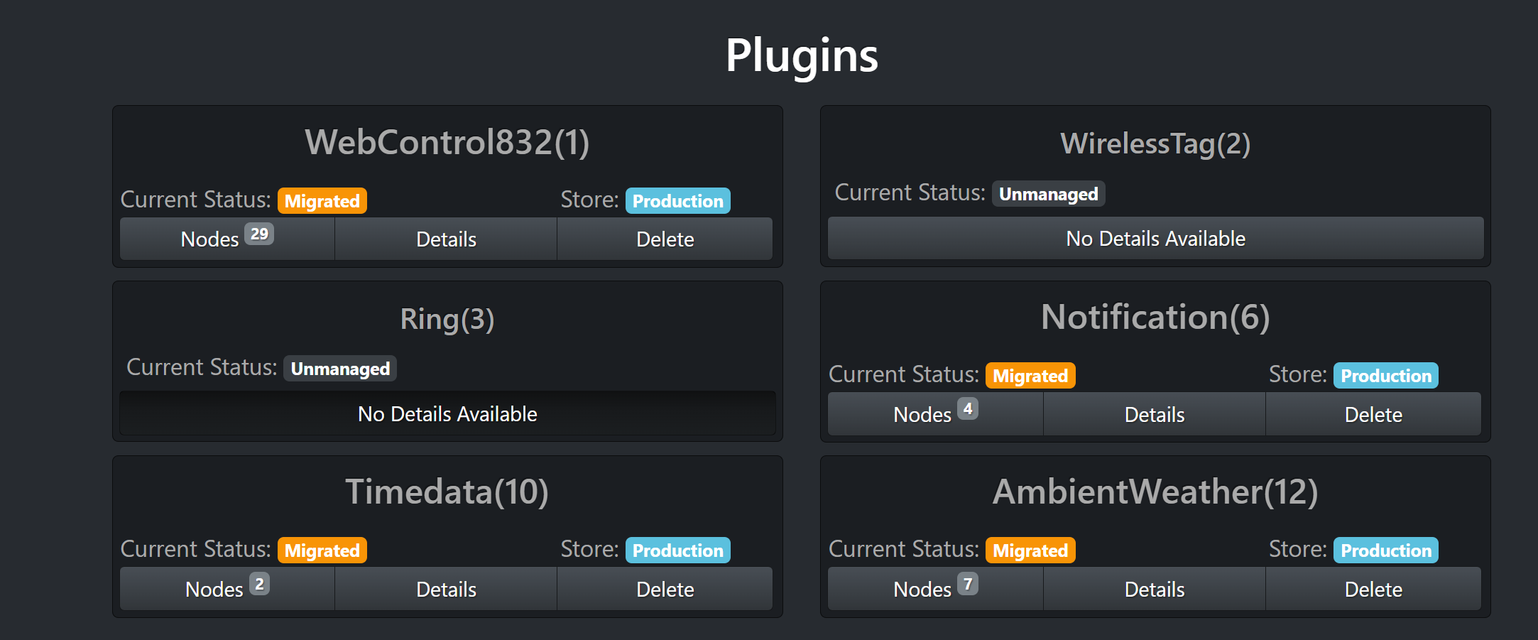

Problem with PG3 plugin moved to eisy-ui plugins
Not sure if the latest update fixed this problem. After updating this afternoons Beta update, ring nodes have appeared in the node list. Tried a power reboot this morning to no effect. Thanks ?
Did something wrong. Tried to move the ring plugin from pg3 to the eisy-ui plugins. Ring plugin shows up in the eisy-plugins with its three nodes. Then went through the process in the eisy-ui to remove the plugin from PG3. Now the Ring plugin is not showing up in the node directory. For the other PG3 plugins moved to eisy-plugins but did not remove from PG3 they are working fine. Not sure what is going on ????

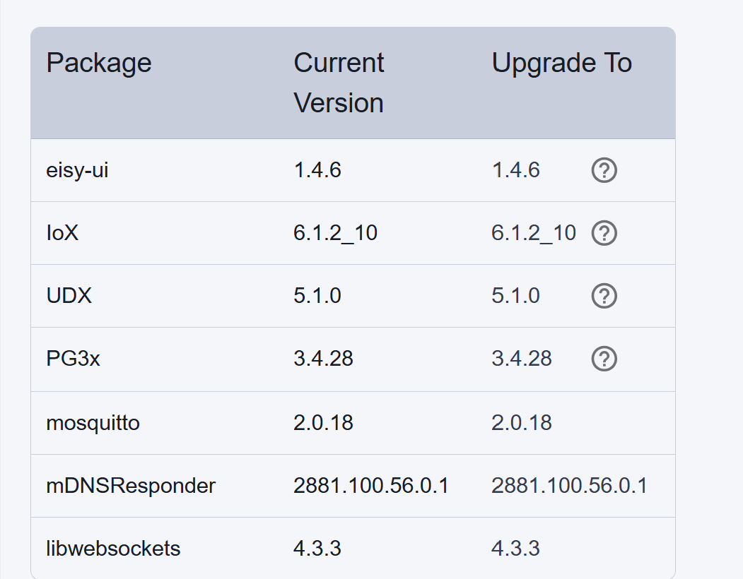

IoX 6.1.1 let's discuss it!
Upgrade now working for all items. Something hanged up durring the upgrade. Opened a ticket and after Michel checked a few things just said to reboot. After three reboots all systems now working, IOX, PG3, UDX and connection to home assistant. Somehow even though I thought I setup the system with a fixed IP address it changed it after the update. Once I fgured this out got PG3 and home assistant working. Now that I can update and change programs in UDX will start switching over to using it rather then the admin consule.
