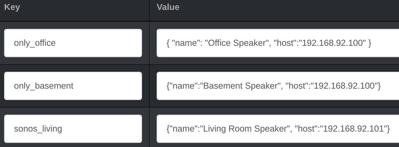

Sonos AMP Multi - New way to address speakers
I think I found and fixed the node status. Do a re-install and it should pick up the fix. I didn't change the version number.
I went and switched back to the original code base and added new features from the hatopg3 one. There are still some issues (some that seem to be bugs in eisy-ui) and I can't really test much. I created a simulated speaker but it doesn't handle any commands, it just allows me to see that the node displays correct. You may have to delete existing nodes before running this version. The version number is 4.0.0 so it will be easy to see that you're on the new version.
I've been making a few changes and I've pushed them up stream so they are available. You just need to re-install to pick up the change. But I'm still having some issues getting things to work properly. I'm starting to think it may be easier to go back to the original code and just incorporate some of the code from the backend.py file so that it's gets the Amp Multi support. I may attempt that over the next couple of days.
Ok, we'll go with that. It should be in the non-production store now (or refresh the store listing to see it). It's called SonosV2
