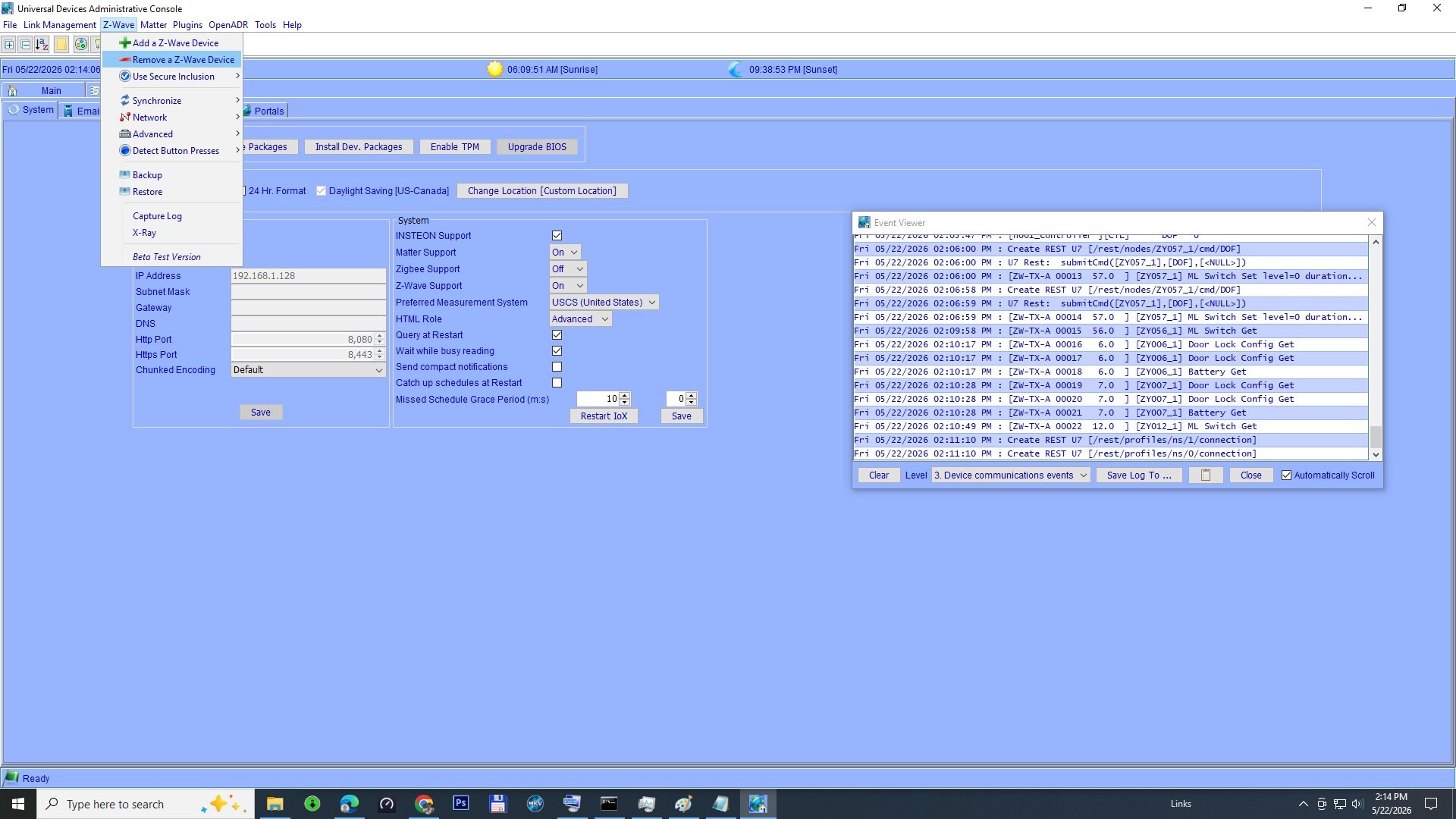

  2. This is what it did, see the picture. After removing it its all good.
  3. I was going one by one locally turning them on and on that one little led on it was blinking and load (fan) didn't work. Removed the switch and rebooted EISY and it all started working. Next it was to find out if it was the switch or the fan in which case load would be under minimum requirement. It was the switch. Very slow and "painful" process.
  4. Well. I can't believe one device can wreck such a havoc. One of my homeseer hs-ws 100+ zwave wall switch failed and it was taking down dongle and whole zwave network. After removing and repairing "damage I caused troubleshooting" everything seems to settle down.
  5. Yes I did 7 hours ago, still waiting on reply thought you guys may have some ideas meanwhile.
  6. Healing network fails. Have spare devices but by clicking " ADD Z-WAVE DEVICE" doesn't even bring up any dialog box anymore
  7. Now by clicking on "Z-Wave" --- "Add Z-wave Device" or "Remove Z-wave Device" does not even open any dialog box in Administrative Console anymore
  8. I tried 30 sec, tried 10 min. Zwave support is enabled. No difference.
