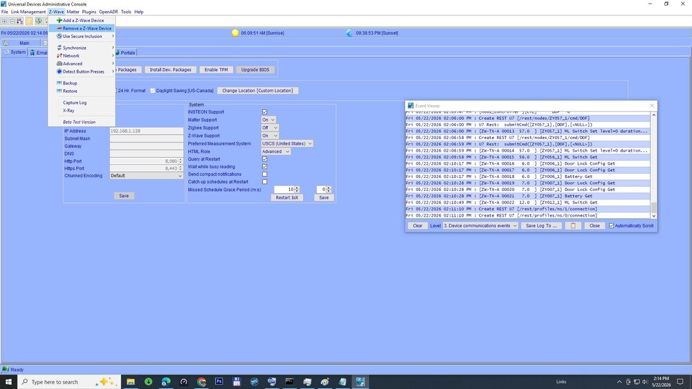

Well. I can't believe one device can wreck such a havoc.
I had a zwave device fail, impacting the response of many other zwave devices. Unlike you, I did NOT experience the impact to IoX or to the dongle. Mine continued to appear to operate normally. While I have come to understand why a single device failure would affect zwave communications, it makes no sense in my head that it would affect the EISY and admin console operation in the ways you describe. Still, I am glad you got it working again.
This is what it did, see the picture. After removing it its all good.
