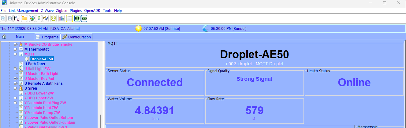

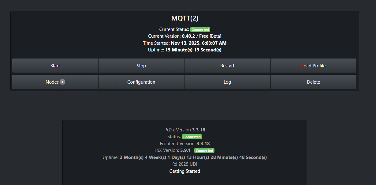

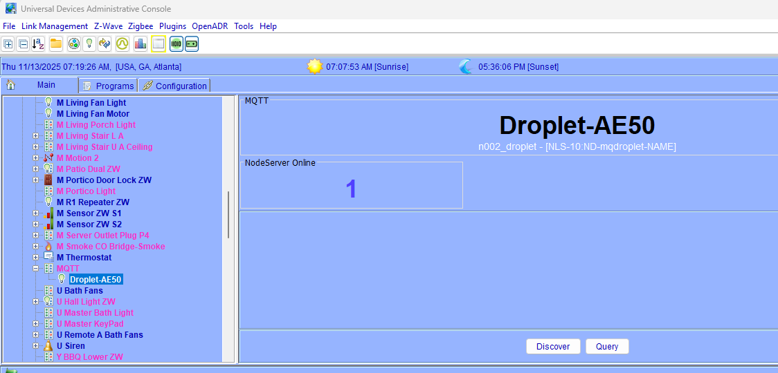

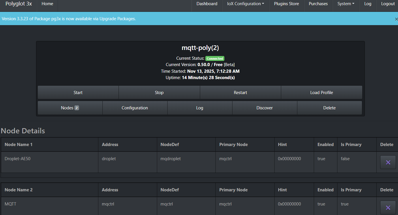

  12. @sjenkins So my second droplet arrived and has been successfully added to MQTT. Thank you for all you help! Once you have moved it into your production MQTT release, I'll re-add everything. But for now, everything looks good with beta. For anyone looking to add this device, here is what I did. 1) In the Droplet phone app -> Smart Home Integrations -> MQTT, configure: Host Name : the local IP address of my EISY Port Number: of my MQTT interface (I used 1884) User name and password of your EISY All other fields blank 2) I added my .yaml file name in the MQTT configuration entry 3) I added the below entries in my .yaml file (I have two droplets). The status and cmd topic entries are the unique value displayed in the phone app, type: must be "droplet", id: and name: are what I chose. devices: - id: "DropletAE50" name: "Droplet-AE50" type: "droplet" status_topic: "droplet-AE50" cmd_topic: "droplet-AE50" - id: "Droplet53B4" name: "Droplet-53B4" type: "droplet" status_topic: "droplet-53B4" cmd_topic: "droplet-53B4" Once I restart my MQTT to pick up the entries, this is what I see in the console: I created a test program to notify on flow and that worked as well. Kelly

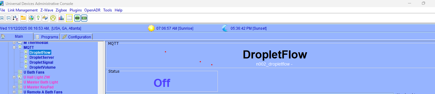

  13. @sjenkins Ends up I was just not patience enough. I am getting the offline status - it appears 3-4 minutes after I disconnect the device. I can live with that. So, what I am still wanting to test is adding the second Droplet. I ordered it late last week so hopefully I get it sometime this week so I can test that. I'll keep you posted. Thanks!

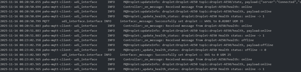

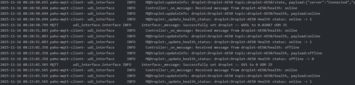

  14. @sjenkins observation and question I have been playing around with the online/offline status. What I notice is that if I unplug the Droplet, the status messages just stop and the status in the console remains as the last status received which was online. The Droplet App on my phone does recognize that the device is offline. Then, when I plug it back in a few minutes later an "offline" message does appear followed immediately by the online status. It looks like the device sends a stored offline message. Sort of useful, but not really since it is very transient. Below I unplugged at 8:20 and plugged back in at 8:23 - and that is when the "offline" message appears followed immediately by the online message. I assume the App has some additional handling of the device to recognize that it has gone offline. And the limitations of MQTT are different. And I understand that. But I do think it would be useful to know when the device is not responding. So, I am wondering if it is possible to add another parameter to the device data to include the date/time of the most recent message. With that I could at least create a notification program if the last date/time exceeds a certain time limit. Is that doable? Or is there a way for the interface to recognize if a device is not "sending"?
  15. @sjenkins My testing is going well. This is the yaml I am currently using. devices: - id: "Droplet" name: "Droplet-AE50" type: "droplet" status_topic: "droplet-AE50" cmd_topic: "droplet-AE50" Couple of questions: 1) I have a second droplet on order. How would the entry of the second one look? Sould all the values be different except the "type". For instance: devices: - id: "Droplet2" name: "Droplet-XX00" type: "droplet" status_topic: "droplet-XX00" cmd_topic: "droplet-XX00" I sort of remember I tried using the following in my original configuration and it did not work with anything except "Droplet" as the "id:" - sorry I don't have the exact log messages anymore, I just know I had to change the "id:" to "Droplet" to get it to work. I sort of remember a message about "DropletH" not found (or something like that). devices: - id: "DropletH" name: "Droplet-AE50" type: "droplet" status_topic: "droplet-AE50" cmd_topic: "droplet-AE50" 2) To then add the new "Droplet", once I update the yaml, do I just restart MQTT in the PolyGlot dashboard to get it to appear in the Console? Or is there a cleaner way? Again - thanks for your patience with me while I learn this new interface. Kelly
