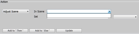

I'm getting started in the programming of the Isy and trying to change or trigger a scene. I have some scenes set up and visible in the tree as scenes but the program section won't populate so they can be used or changed.
Ideas?
What specifically are you trying to accomplish? Adjust Scene is used to change one or more settings on an already created scene, for example, On-Level, based on a particular condition, otherwise run the scene as created. What's the result when you clock on the down arrow?

Change the levels of the scene based on time of day or a flag. Like have all the security lights on a scene and have it turn on at sunset to 40% but go to full if there is motion. After x minutes of no motion it would then drop back down to 40%.
When clicking on the drop down, it is blank. FYI, the screen cap is with the drop down expanded but it is blank.

I just tried it in 5.0.11b and it is populated in it but it was not what I was thinking it was or expecting...

Michel, This was my bad. Once I upgraded to 11b the scenes populated correctly. Then, when I initially saw they were populating, I must have been looking at a switch that didn't have a dim option or there was a program delay. The only options I had for the device were Command, Default and Ignore. I have since tinkered and was able to get the options that made more sense - like the flyout to set device dim levels. It turned out to just be a pothole in my learning curve...
