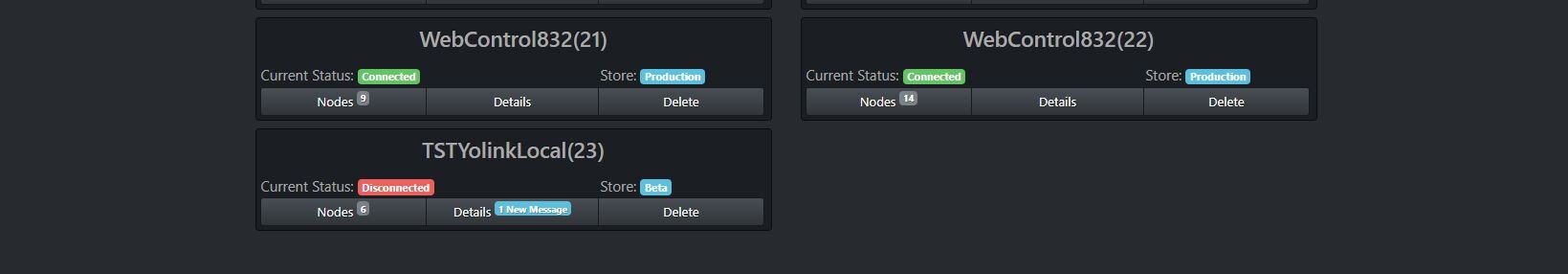

@Panda88 looks like the TSTYolinkLocal is now dead in the water.  The "subscription" is out of date & it has shut down.  Won't restart or re-install or update.
Not sure what is required to give it a jolt, but would appreciate more time on it until the production version makes is out of your shop ;)

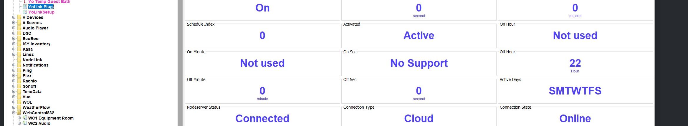

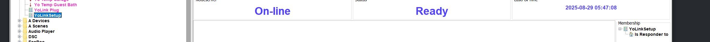

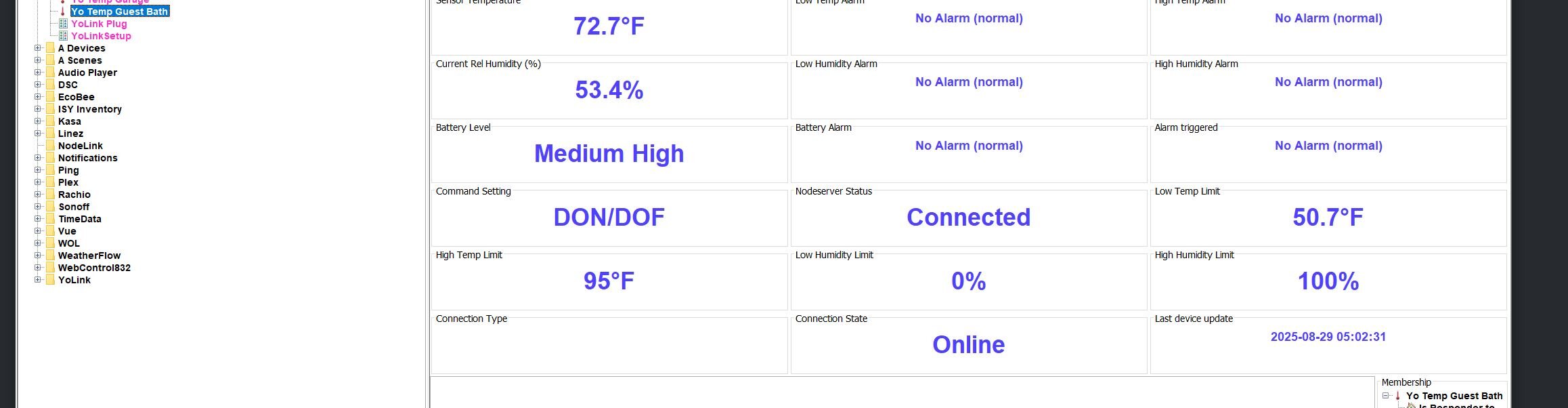

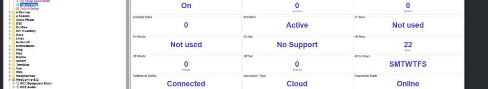

@Panda88, I too have lost access due to expiration date.  I know you are working on it. I also wanted to report that while PG3 shows the plugin as disconnected, the devices seem to show as being connected. And some show Cloud, 1 or two show Local.  Please see screenshots
-Tim
