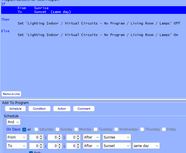

1- For dusk - dawn automation, you create an iox program that looks like this
New Program - [ID 005E][Parent 0001]
If
        From    Sunrise
        To      Sunset  (same day)
Then
        Set 'Lighting Indoor / Virtual Circuits - No Program / Living Room / Lamps' Off
Else
        Set 'Lighting Indoor / Virtual Circuits - No Program / Living Room / Lamps' On
This is how it looks in iox when you do it, substituting your scene for my sample above
The Set ... lamps on is my scene for 2 lamps, turn the Scene on and off, not the individual devices. The scene icon looks like this in iox
2- Use the same scene in UD mobile... Turn the Scene on and off, not the individul devices.
Hope this answers it

I entered the program (for my scene which is named "Welcome Home") but I think that it will turn on that Scene in the dusk to dawn interval and turn it off in the dawn to dusk interval.  That is not exactly what I am looking for.  What I want is that when I go into UD Moble and tell it to turn on "Welcome Home" it will disobey me during daylight hours but will obey me when it is dark.  Conversely if in UD Mobile I tell it to set "Welcome Home" to "OFF" I want that to always work no matter the time of day.  In a similar manner if I setup that scene in a UD Mobile Geofence to turn on "Welcome Home" it should turn on the lights if I drive into the GeoFence around my home and it is dark but not turn them on during the daytime.
