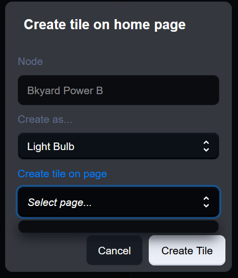

@bmercier updated to 5.5 and I'm trying to add a tile to my Favorites page but I'm stuck at Create tile on page.
I clear cache and tried on both Chrome and Firefox.
I'm not sure if it ever worked as I jumped onto this thread at 5.4. (new EISY)
Thanks for your feedback. After investigation, I found out the problem and just released 0.5.6. Basically, the problem was that you don't have a home page created yet. 0.5.5 should have created one automatically on startup, but due to a build issue, it did not.
Could you try by using the AC on port 80 or 443 (eisy-ui's server ports)?
