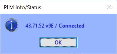

The PLM info status shows connected. I moved my EISY and PLM to an outlet right next to the service panel (they had been further away in a mechanical room). I installed an access point on the other leg in another outlet near the panel. I also added one more access point further away as we have a large house. Moving things to next to the panel didn’t seem to improve things.
The cookbook mentioned counting the number of links with the 2413s being limited to around 900 links. The count was 615 for my system.
@apostolakisl You mentioned that perhaps the devices not communicating. Would my troubleshooting of successfully adding and removing the 2334-2 switch suggest that the eisy and PLM are working correctly?

If the 2334 Switch added then your PLM and its connection is good.
